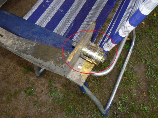

Here are attached some Internet pictures of the missing special thick nuts&bolts.
I circled the missing parts in red in each picture.
I would highly appreciate help on this matter because these side steps weren't cheap to obtain (expensive postage) and I had no clue that these missing parts even existed until a thorough Internet picture search ...
It appears that these missing parts are common for any model of OEM side steps.

Replied by Lambert on topic Side steps OEM - solution for a missing mounting part
Ah yes the infamous spreading sleeves. Your best bet is to find someone with a lathe and make some to fit your car.

That is one of the options.
But I need some measurements or drawings to begin with. Could someone remove one OEM side step from their Jimny and take some measurement of this bolt and sleeve for me?
That would be an excellent opportunity for them to coat the bolts with some anti-seize compound for future removal.

by Scimike
Replied by Scimike on topic Side steps OEM - solution for a missing mounting part
I assume said rawbolt fits into one of the chassis cross tubes, if so can't you just measure the chassis tube?
Give yourself a.5mm clearance to allow it to slide in, looks to be about 40mm deep, but I doubt it needs to be super accurate and the bolt is the biggest that will fit the hole in the side step bracket.
Alternatively weld a plate over the chassis tube with a nut welded centrally on the inside of side plate, instant captive support bolt point.
Sorry if it's more complex than this.
Only trying to help.
Like Scimike says the necessary dimensions are easily measured from the step and chassis and if your engineer has a picture of the expansion fitting they should be able to produce a working solution. If they need a full dimensioned print to make one then they aren't an engineer and you need to look elsewhere.
