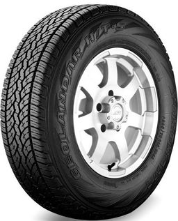

HT tyre class
Main traits
- Highway terrain tyres are generally meant to be used predominantly on road, with only slight & light off road excursions (dirt roads, possibly rougher gravel at most, etc.).
- The overall tread design and depth of HT tyres is generally quite similar to ordinary road tyres.
- That means that HT tyres generally have equally proficient on-road performance and endurance even for sharp or very fast driving (and similar fuel economy).
- That also means that HT tyres exhibit almost equally bad all-terrain performance as ordinary road tyres.
- However, having the "terrain" part in their name, HT tyres should be slightly more robust than ordinary road tyres.
Conclusions
- For (almost) always on-road driven all terrain vehicles, HT tyres can be an optimal choice if the vehicles are driven sharply or at high speeds.

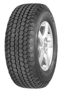

- All terrain tyres are generally meant to be used in mixed on-road and all terrain conditions (anywhere between 30% and 70% of time for either).
- AT tyres usually have significantly rougher (and a bit deeper) tread design compared to HT and ordinary road tyres.
- AT tyres are a performance compromise which is usually hard to achieve.
- AT tyres are generally good on-road except for sharp or very fast driving, and generally good off-road except for boggy and/or harsh conditions (deep mud, deep snow, sharp rocks, river crossings ...).
- AT tyres are usually significantly more robust than ordinary road tyres.
- AT tyres should slightly impact fuel economy.
- AT tyres can be a challenge to balance properly.
- Many AT tyres are "all season", which further adds to their "all terrain" value.
- For example, mountaineers can encounter ice and snow even as late as in June and as early as in September.
Conclusions
- For all-terrain vehicles which are used for everything - commuting, intercity travel, and various all terrain conditions, AT tyres are the solution.
- AT-class tyres should not present a jeopardy on the road, and they should be a trusted companion off the road, in the sense of traction and in the sense of reliability.

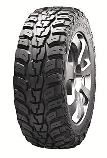

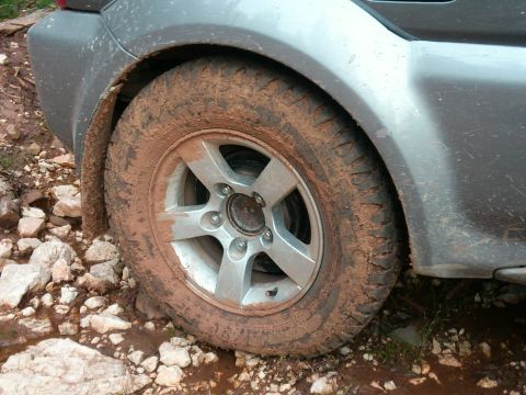

MT tyre class
Main traits

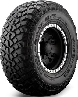

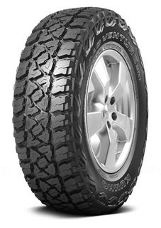

- Mud terrain tyres (also called "Maximum Traction") are generally meant to be used predominantly off road, with only slight easy-going on-road excursions.
- MT tyres usually have very deep and striking ("tractor looking") tread and sidewall appearance, and very high robustness capability through various reinforcements.
- MT tyres excel in boggy and/or harsh conditions (deep mud, deep snow, sharp rocks, tree roots, river crossings, etc.) and offer the best protection against punctures, cuts and chipping.
- However, MT tyres are generally noisy on the road, wear faster and present a real jeopardy if not driven slowly and carefully on a wet road and especially on packed snow or ice.
- Also, MT tyres usually significantly affect fuel economy.
- Due to their coarse construction, MT tyres can be very hard or impossible to balance properly.

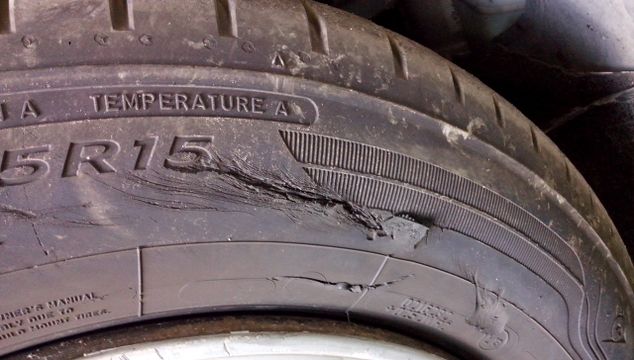

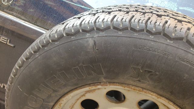

- For all-terrain duty, the strength and robustness of tyre's sidewalls are equally important as the tread pattern.
- There are also horror stories of retreaded tyres failing catastrophically during high speed driving.
- The tread layer actually glues off from the tyre carcass.
- The consequences don't look pretty from any angle of view.

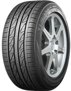

- Examples of ordinary road tyres with symmetric bi/non-directional tread layouts

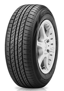

Hankook Optimo H724
Bridgestone Potenza RE92
Bridgestone Turanza AR10

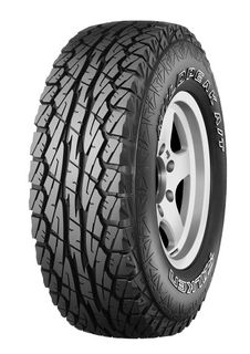

- Examples of HT/AT/MT tyres with symmetric bi/non-directional tread layouts
Yokohama-Geolandar-HT-S
General Grabber AT3
Goodyear Wrangler AT-SA
Falken Wildpeak WP AT01
Kumho Road Venture MT51

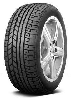

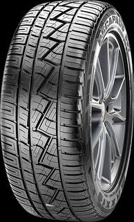

- Examples of ordinary road tyres with asymmetric bi/non-directional tread layouts
Pirelli P-Zero System Asimmetrico

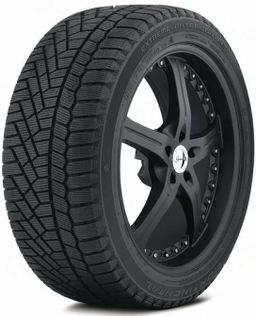

Continental WinterExtremeContact

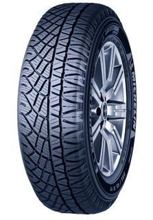

- Examples of HT/AT/MT tyres with asymmetric bi/non-directional tread layouts
Maxxis Escapade CUV
Michelin Latitude Cross

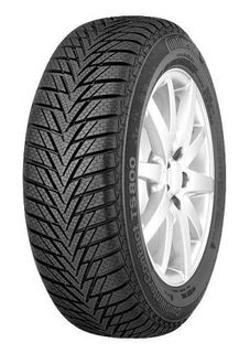

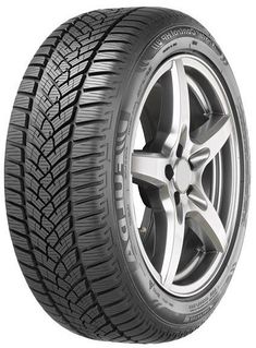

- Examples of ordinary road tyres with symmetric (uni)directional tread layouts
Hankook Ventus V12 Evo K110
Continental WinterContact TS800
Fulda Kristall Control HP2

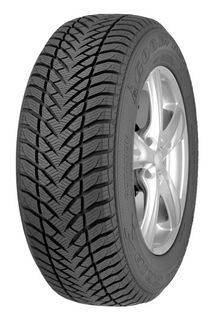

Goodyear UltraGrip plus SUV
- Examples of HT/AT/MT tyres with symmetric (uni)directional tread layouts
Kumho Road Venture MT KL71
Yokohama Geolandar MT

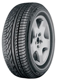

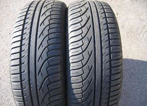

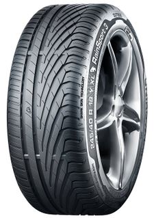

Uniroyal RainSport 3
Michelin Pilot Primacy

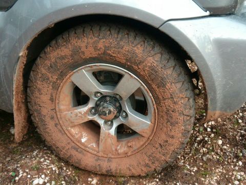

Regarding "tyre vs. vehicle body" collision risks
For Jimny 3
Sizes 205 / 75 / R15 and 195 / 80 / R15 generally have no risks of collisions with the vehicle's body, with two exceptions:
- If you have a 2nd gen. front bumper (see below), you might have to straighten it if it is sagged, or trim it just slightly (invisibly) on the bottom (simple job with a grinding tool).
- If you have front mud flaps, you might have to trim a plastic spacer behind them (which is easy to dismount and mount) by approx 10-15 mm.
Size 215 / 75 / R15 could be more problematic:
- It may require some trimming of the bottom of the front bumper, especially if it is a 2nd gen. bumper.
- Front mudflaps will probably need to be removed.
- The spare tyre might contact with the rear bumper.
- Wheel arch trimming is generally not needed, except if wheel spacers are used without a lift.
- Brazilian "HR" (2010-2012) "4sport" and "4work" (untill 2016) Jimny editions (which came with "215 / 75 / R15" tyres from the factory), also came with an approximate 25 mm body lift from the factory (to remedy the collision risks).
- The Brazilian "4sport" edition also had a minimalist front bumper, which increased the clearance in front of front tyres (eliminating the collision risk when steering) and provided higher approach angle.

Here are the AT tyre models with which Jimny owners have had great or quite good experiences with:
- Goodyear Wrangler AT/SA+
- General Grabber AT (not AT2!)
- Continental ContiCrossContact AT
- BF Goodrich AT/KO2
Additional notes:
- All of the above listed tyre models have proven themselves as being very good on-road in any time of year, while also proving to be rather versatile off road.
- Also, General has recently (09/2016) released model AT3, which looks very interesting indeed.
- Avoid the model AT2, it is very old and deprecated one!
- Grabber AT2 is actually older than Grabber AT.
- Many other AT tyre brands and models not mentioned above might also be quite good - investigate on your own!

- Kumho Road Venture KL71 ((uni)directional!)

- For example, a sidewall puncture is generally impossible to repair properly.
- You will have to discard the remaining three tyres and buy all four/five new tyres - what a waste.

- Example of Goodyear Wrangler AT/SA+ 205 / 75 / R15 tyres on a Jimny 3, when deflated from stock 1,7 bar to 1,1 bar
Notice the relatively large contact area with the ground
Notice how the tyre deforms to accommodate uneven ground under it
- Reducing air pressure in tyres from standard on-road pressure usually provides significant advantages when driving on unpaved surfaces and in off-road conditions.

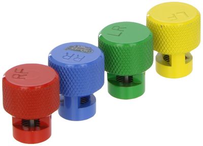

However, there is one type of tyre air deflation tool which is certainly worthy of consideration:
- It is a "dumb" die-cast, push-pin, screw-on-valve tyre deflator.
- Such tools are usually the cheapest of them all.
- They are super reliable as they have no moving parts.
- As a matter of fact, they are usually a single-piece cast metal.
- It can't get more robust than that!
- Such deflators simply push the tyre valve's pin in (as you would do with a stone) all the time while they are screwed onto the valve.
- This lets the air out of the tyre at the same rate (speed) as you would with a stone, until you unscrew them.
- So they are harmless to the valve, as they do not fiddle with the valve core to increase deflation speed, as all of the "super fast" deflators do.
- In summary, these deflators do exactly the same thing as you would while pressing the valve pin with a stone, but in a more elegant manner.
- They have no deflation control mechanisms, so the user must take care to unscrew them at the right time (to avoid over-deflation).
- There are three advantages of this type of deflators over the stone age method:
- No need to crouch next to the tyre all the time during deflation;
- Also avoids having to endure the burst of freezing cold air from the tyre valve over your fingers all the time during deflation;
- If you are well organized and follow the timings, one person can deflate two tyres almost in parallel;
- Тhis doubles the overall deflation speed and brings it practically on par as with the expensive fast tools.

- Sidewall puncture is the nastiest type of tyre damage.
- Unfortunately, the risk of sidewall punctures is generally the highest when performing all terrain driving.
- A sidewall puncture can happen either as a more or less round pierce (for example a nail), but much more often as a cut (for example a piece of a tree branch sticking out from the ground).
- For the predominant radial tyres, general tyre industry convention is that any damage in the sidewall area can not be successfully repaired.
- Examples of tyre sidewall punctures
Multiple damages in one picture
A relatively small but terminal damage
