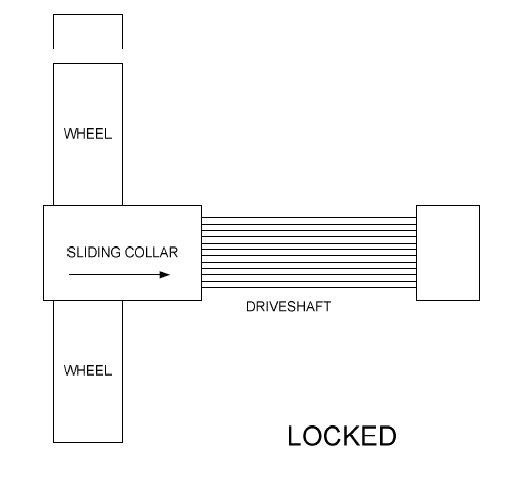

  • The vacuum operated free wheeling hub heads fitted to the Jimny 3 are “sliding collar” designs.
  • The collar is pulled onto the drive shaft or pushed off from the drive shaft (depending on the need) by the vacuum from the engine.
  • This highly simplified picture shows the theory.
  • The sliding collar on the picture in in the locked position, as it is slid on the drive shaft, so the drive shaft and the wheel are in a solid connection.
  • When the collar moves to the left, it is out and is not engaged on the drive shaft splines.
As stated, the diagram is highly simplified and there are a few key points to remember:
  1. The vacuum makes the collar slide in the desired direction (depending on through which route the vacuum came), but then is NOT required in order to hold the collar in position.
  2. Once the collar has slid in either direction, it will stay there through the use of magnets and friction.
  3. The vacuum is used only to make it slide both to lock and unlock by changing the route of the vacuum (valves and switches control the route).
  4. Removing the vacuum tube from a locked hub assembly will not unlock its hub head.

Problem 9 - Hub head clogged or worn
  • It is fairly simple to demount a free wheeling hub head from the wheel hub assembly and check if it is clogged or worn.
  • Just make sure that you mark the exact position in which the hub head was mounted and to mount it in the same position later.
  • This principle minimizes the chances of improper seating, therefore minimizing the chances of air leaks.
  • If the inside of the hub head is filled with grit or dirty grease (or if it has an excessive amount of grease), its operation can be hindered. Clean it and regrease it.
  • Do NOT over grease the inside of the free wheeling hub head!
  • Excessive amount of grease can hinder the operation of the sliding collar, or even block the passage of air/vacuum.
  • If the teeth on the sliding collar or on the main hub head casing are excessively worn, then you might need a replacement hub head.
  • They should be obtainable from vehicle junkyards (or from other Jimny owners who switched over to manual hub heads) for a reasonable price.
