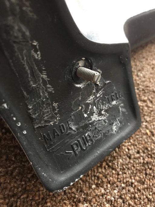

Figure 01 - foot of a second hand OEM spoiler with the "grub/set" bolt

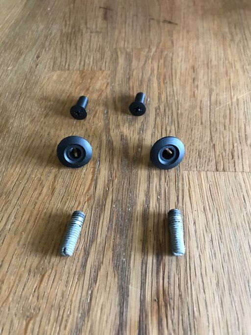

Emulating original principle
  • Although you probably won't have the original plastic sockets, and perhaps not even the original set/grub bolts, a similar DIY solution to the original fixing method can be achieved.
  • The idea is to get a pair of some kind of plastic sockets (perhaps from a vehicle trim set) and to get a pair of set bolts, and to make them thread into each other.
Figure 02 - bolts and sockets
  • Pictured in the front are the two original set bolts which Suzuki supplies with the original spoiler.
  • Behind is a pair of expanding trim tags.
  • Pictured in the background is a pair of plastic screws from the trim tags.
  • The screws will not be needed and can be discarded.

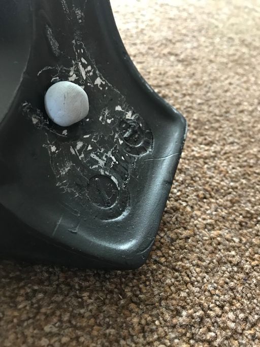

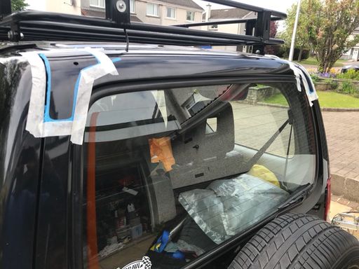

Figure 03 - putting on the "marking" material onto the spoiler feet

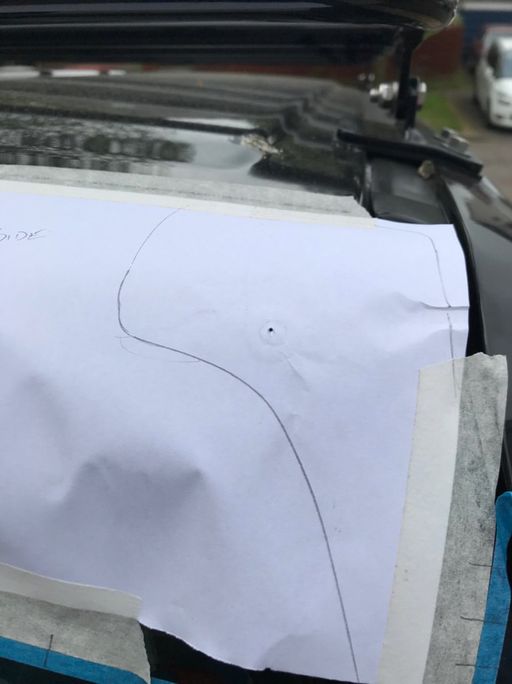

  • Initially I decided on using a paper template that I stuck it onto the car and drew around the foot of the spoiler to get a location.
  • I marked the position of the paper on the car with tape and pencil lines to aid relocation.
  • Then I took it off and pressed with my finger onto the underside of the spoiler to make an indent on the paper of the threaded insert of the spoiler.
  • I wasn’t convinced I had it spot on so I decided a cuppa would help.
  • So, after much head scratching I thought about a blob of blu tac.
  • I wiped a bit of polish onto the contact area of the spoiler before I placed the blob of blu tac onto each fixing point.
Figure 04 - Imprint of the threaded position on the spoiler foot
  • I lined the spoiler up with the template on the car and pressed on then gently removed the spoiler.
  • Because I had put a spot of polish on the fixings, the blu tac stuck to the paper and stayed with the car.

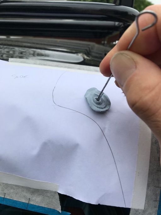

Figure 05 - punching a hole through the middle of the marking point
  • A quick jab with a skewer made a centre point.
Figure 06 - center hole punched through the paper
  • After removing the blu tac from the paper, now I got a precise centre point imprint.

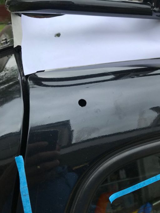

Drilling the holes
Figure 07 - a drilled hole in the rear door
  • Now this is the point of no return!
    • Now the drilling starts.
  • If you are using this as a guide, quadruple-check that you are happy with the position before you start drilling.
  • With a centre punch mark the door to give the drill a starting point.
  • The safest drilling procedure would be to make an initial hole with a 2-4 mm pilot hole and step up 2 mm in drill diameter each time till you drill an 8 mm hole in the rear door.

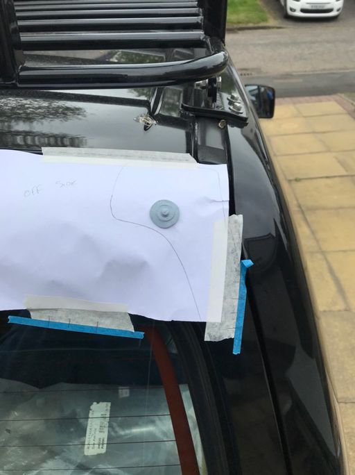

Test-fitting the spoiler and painting the holes
Figure 08 - test fitted the plastic trim piece / "socket"
  • This is how the hole should look like after inserting the plastic trim piece / "socket".
  • But don't leave it there yet, because you need to rust-proof the drilled metal first!

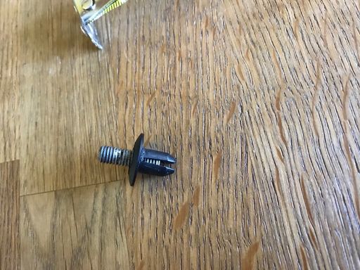

Figure 10 - insufficient length of the set bolt to properly spread the plastic trim piece's legs into jam-lock width
  • When I took the spoiler off after the trial fit, one of the trim nuts came out and proved that the original threaded grub bolts were too short and the trim but legs weren’t spreading sufficiently to jam the trim in the drilled hole.
  • Therefore, it is advisable that you obtain a bit longer set bolts.

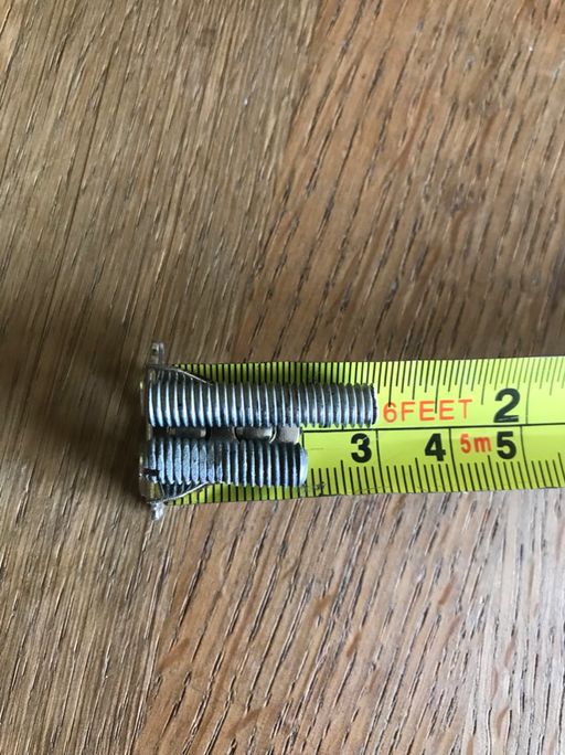

Figure 11 - original set bolt and longer DIY set bolt
  • You can make your own set bolts if you just cut off a head of a regular bolt.
  • The original set bolts are 20 mm long, so it is advisable to obtain 30 mm long set bolts.

Figure 12 - masking off the area of door around the contact area with the spoiler feet
  • Some people decide to also use glue in addition to screws to additionally secure the spoiler onto the rear door.
  • In this case, it is advisable to mask off the area of the door around the contact area with the spoiler feet, to prevent the spilling glue from making a mess on the surrounding areas of the door.

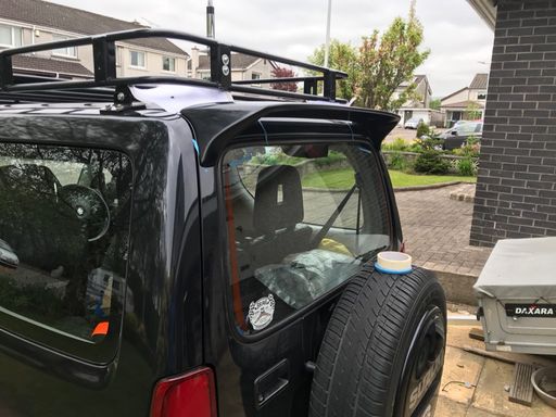

Figure 13 - finished installation
  • The glue was placed around the drilled hole and the plastic trim sockets were pushed into the drilled hole.
  • The DIY 30 mm set bolts were wound into the spoiler feet.
  • The glue was used on the feet of the spoiler and on the future contact area on the door, and the spoiler was pushed home onto the rear door.
  • While the glue was still soft, the masking tape was removed to clear up the small amount of glue that had escaped.
  • The spoiler was then left on the car and supporting itself while the glue cured.
  • I added some masking tape again to be sure.
