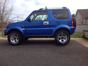

Kits
Standard Jimny
An unmodified 2005 VVT Jimny (UK) for comparison.
Trailmaster 2" Lift kit
The Trailmaster 2" Lift
(see BigJimny Store )
JimnyBits 2" lift
Jimny fitted with JimnyBits 2" lift kit
KAP Suzuki 3" lift
Jimny fitted with KAP Suzuki 3" lift kit
Tough Dog 120mm lift
Jimny fitted with Tough Dog 120mm Lift (Australia)
Note: I think the 120mm lift is an 80mm lift with extra spacers?
