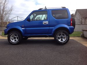

Standard Jimny
Standard Jimny
An unmodified 2005 VVT Jimny (UK) for comparison.
