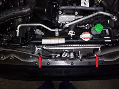

Top fixings
  • From under the bonnet remove two plastic push rivets by prising out the centre pins using a small flat-head screwdriver.

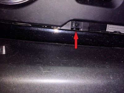

Bottom fixings
  • At the bottom of the grille in the lower horizontal slot release two clips (Philips screwdriver, quarter turn).
