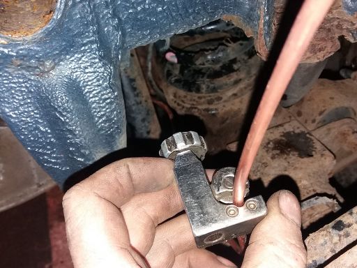

Figure 01 - Cutting the brake pipe at a rear wheel
  • I start by clamping off the rear brakes.
  • I'll be bleeding the whole braking system later, but doing this now maintains the fluid level in the rest of the system and lessens the chance of having air trapped somewhere.
  • Rather than mess about I cut the old brake pipe at the brake pipe end.

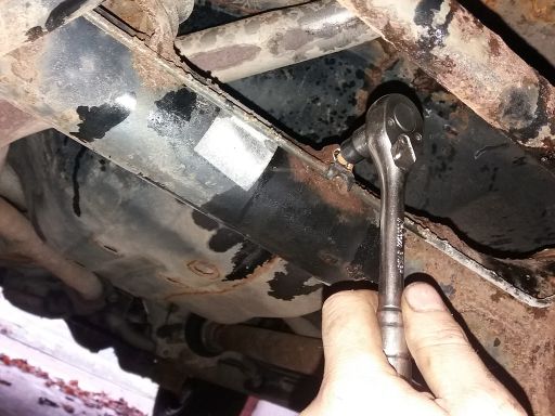

Figure 06 - Removing the self tapping bolts
  • They are 10 mm self tapping bolts.
  • If you can get them off without an issue, that's great.
  • But if the bolts are seized and you risk damaging them during removal, bear in mind that a bag of 10 new bolts from Ebay costs only a few pounds.

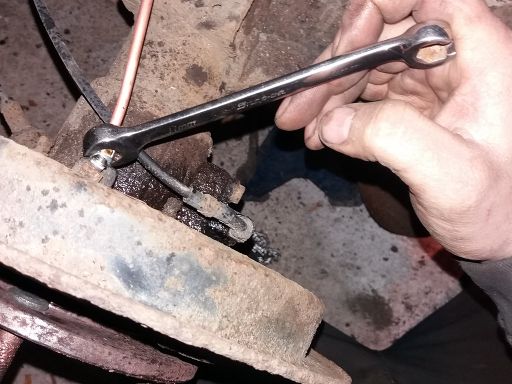

  • Screw the end into the wheel cylinder etc. with your fingers.
  • This can be tricky on a Jimny, as the pipe does not fit in at right angles to the cylinder.
  • Once its started, tighten it up.
  • I'm using a brake pipe spanner but you don't really have to.
  • Remember, you are tightening it up to compress the seal on the pipe.
  • You don't want to tighten it up until your arm is shaking!
  • Don't hold the spanner at this angle unless you want to punch the underside of a Jimny!
