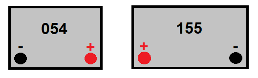

  • The terminals are the relatively small Japanese (JIS) post type with the positive (+) terminal to the right of the negative (-) as you hold the battery with the terminals closest to you.
    • See the picture of the terminal layout further below in the article.

Battery terminal layouts
Positioning layouts of battery terminals on suitable battery types for Jimny 3
  • The layout shows the terminal positioning of both 054 batteries (discussed earlier in the article) and 155 batteries (discussed later in the article).
  • Note that the positioning of the terminals in 155 type batteries is inverse when compared to 054 batteries.
  • This means that a 155 type battery has to be installed in an "inverse" position in the engine bay (in relation to how a 054 battery would be installed) in order for the cables to reach the battery terminals.
  • Being in an "inverse" position in the engine bay is not a problem and the cables still can reach the battery terminals.

    • The terminals are the relatively small Japanese (JIS) post type with the positive (+) terminal to the left of the negative (-) as you hold the battery with the terminals closest to you.
      • See the picture of the terminal layout earlier above in the article.
