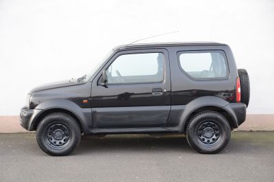

2WD-only Jimny exterior
2WD-only Jimny interior

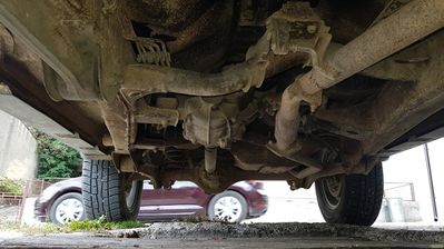

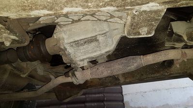

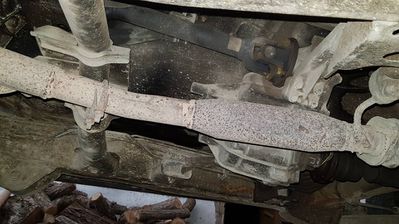

- Dummy transfer case, close-up
View from the front side of the vehicle
View from the right side of the vehicle
View from the left side of the vehicle
- Notice the absence of a connector for the front propeller shaft (toward the front differential).
- Notice a set of wires connected to the transfer case - that's probably just for the speedometer.

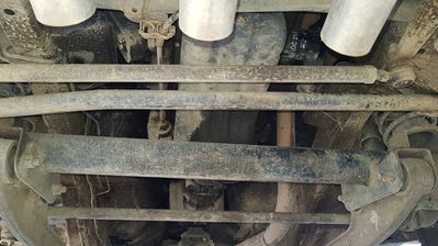

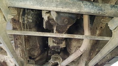

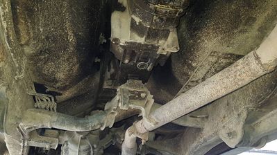

- Dummy transfer case and surroundings
The transfer box and the gear box
View at the rear part of the vehicle
- Notice the absence of the front propeller shaft.
- Notice that the rear section of the vehicle's underbody is the same as in a proper 4WD Jimny.

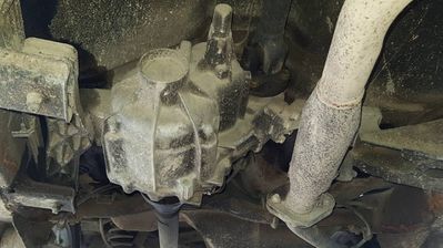

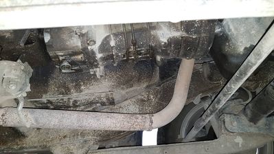

- Gear box
- The gear box should be the same as in proper 4WD Jimnys from the same era.

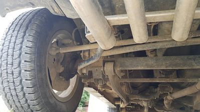

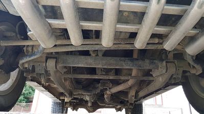

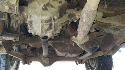

- Front axle, center part
Complete overview of the front axle
Close-up on the center section
- Notice the complete absence of the front differential case.
- The front axle is just a single-piece hollow tube - called a "dead solid axle".

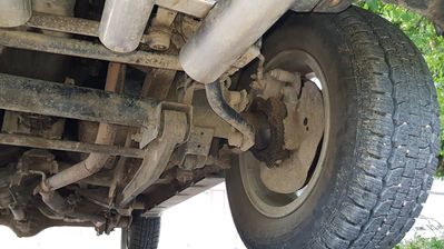

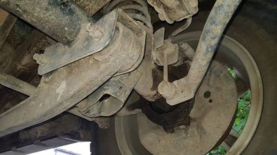

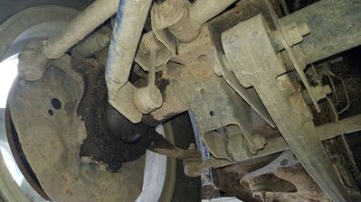

- Front axle, at front wheel hub connection
Front left wheel
Front right wheel
- Everything on the pictures is exactly the same as in 4WD Jimnys.
- Exceptions:
- The lack of vacuum pipes for the front wheel hub heads;
- No connections for the vacuum pipes on the front wheel hubs;
- No ABS sensors on the front wheel hubs (although some 4WD Jimnys also lack ABS);

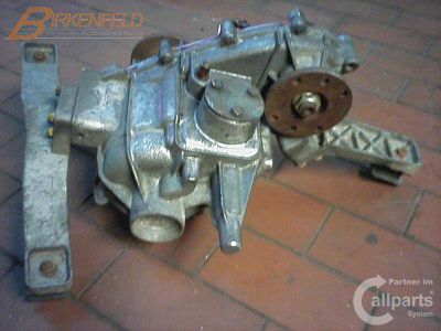

Transfer case, mechanically operated
- A standard, mechanically operated Jimny transfer case with all the gearing inside, together with a mechanical operating lever.
- This transfer case model was used in Jimnys built from year 1998 to year 2005.
- This transfer case model is bolt-on compatible and will fit into a 2WD-Jimny like it's an original installation.

Differential gearing ratios
- The gear ratio of the front differential has to be exactly the same as the ratio of the rear differential.
- One (less certain) way of achieving this is to get the parts from a donor 4WD Jimny vehicle which has G13BB engine, as those vehicles should have matching front differentials.
- 4WD Jimnys with non-VVT M13A engines (made from 2001-2005) should also have matching front differentials, but this is not that much certain.
- The other (100% certain) method of achieving this is to measure the gearing ratio of the front differential from the donor vehicle and compare it to the measured gearing ratio of the factory rear differential in your 2WD-only Jimny.
- If the gearing ratios are the same, then you have a match.
The wiki article "Differential information" might contain some useful info.
How to measure the gearing ratio of a differential:
- Manually turn the input side of the differential (side onto which the propeller shaft connects) a set number of times (for example 10 full turns) while keeping one output side of the differential jammed.
- Then count how many turns has the other (free) output side of the differential performed for the set number of turns of the input side.
- The gearing ratio is then calculated by dividing the two numbers.
- Example: By turning the input side 10 full turns, the output side has turned 38 turns.
- This results in 3.8 gearing ratio for the differential.

Dummy transfer case removal
- Optional: drain the oil from the dummy transfer box (if it has any oil in it).
- Mark the positions of both propeller shafts in relation to the casing of the dummy transfer box.
- This refers to the rear propeller shaft between the transfer box and the rear differential, and the small propeller shaft between the gear box and the transfer box.
- Put those marks on the new 4WD transfer box in the same spots on which you put them on the dummy transfer box.
- Disconnect both propeller shafts from the dummy transfer box.
- Dismount the dummy transfer box from the vehicle.
- You will not need this transfer box any more.
- It's best to donate it to a technical school so that pupils can study how economics influence engineering decisions.
Dummy front axle removal
- Remove both front wheels.
- Disconnect the brake pipes from the front brakes.
- Try to immediately plug the brake pipes with something so that the least amount of brake fluid (which is highly corrosive) leaks out.
- Optional: Dismount the front brake pads, discs and calipers from the wheel hub assembiles.
- This step makes sense only if you intend to reuse the front brake components on the vehicle after fitting the new 4WD front axle assembly.
- Put two stands below the front axle so that it rests on them.
- Disconnect both tie rod ends from the front wheel hub assemblies;
- Optional (if you want to separate the front wheel hub assemblies from the front axle):
- Dismount the steering knuckle swivel seals from the wheel hub assemblies (leave the seals hanging on the axle casing);
- Remove king pins from the front wheel hub assemblies.
- Remove the wheel hub assemblies from the axle;
- Remove the swivel seals from the axle casing;
- Note: You would to this only if you intend to reuse the parts from the wheel hub assembly, like the king pins, steering knuckle swivel seal, wheel bearing, etc.
- Note: It is not recommended to reuse any of those parts except possibly for the king pins and the swivel seals (if they are in very good condition). Better buy hem new.
- Disconnect both front shock absorbers from the front axle (leave them hanging on the vehicle);
- Disconnect the panhard rod from the front axle;
- Disconnect both anti roll bar links from the front axle;
- Disconnect both radius arms from the front axle;
- Disconnect both coil springs from the front axle;
- Finally, the front axle assembly should now be completely disconnected from the vehicle.
- Just lower it down and take it away.
- You will not need the front axle (+ front wheel hub) assembly any more, so you can donate it for example to a paramilitary group of your choice.
- They can use it on a makeshift trailer for towing light artillery.

Transfer box
- First of all, consider installing an extended transmission breather to the 4WD transfer case while it is still dismounted.
- The wiki article "Transmission breathers" contains further details.
- In the cabin, cut out a hole in the floor carpet where the transmission lever is going to be.
- Now cut a suitable hole in the floor panel in the same place where you cut the carpet hole.
- The best way to determine the exact position of this hole is to measure its position in another "normal" 4WD Jimny which has the transmission lever.
- Rust-proof the cut-out in the floor panel.
- Mount the 4WD transfer box on the vehicle, with the transmission lever protruding in the cabin.
- Dress the rubber gaiter around the transmission lever.
- Connect the small propeller shaft from the gear box to the transfer box.
- Don't forget to properly align the propeller shaft to the transfer box according to the marks which you had made before.
- Connect the rear propeller shaft from the rear differential to the transfer box.
- Fill the transfer box with suitable transmission oil.
- Try the transmission lever with the vehicle turned off and see if it moves correctly.
Front axle assembly
- Note: It is assumed that the "front 4WD axle assembly" is already complete.
- This means that the differential, half shafts, CV joints, and the front wheel hub assemblies are installed / connected to the axle casing.
- Manual or fixed front wheel hub heads are also assumed to be installed on the front wheel hub assemblies.
- Note: It is also assumed that the front brake components are already installed on the wheel hub assemblies.
- Bring the 4WD front axle assembly up to the front end of the vehicle and put it on two stands.
- Drain the old oil from the front differential (as you keep on working around, the last bits of oil will leak out).
- Connect both radius arms to the front axle;
- Connect both front shock absorbers to the front axle;
- Connect both coil springs to the front axle;
- Connect both anti roll bar links to the front axle;
- Connect the panhard rod to the front axle;
- Connect both tie rod ends to the front wheel hub assemblies;
- Connect the brake pipes to the front brake calipers;
- Optional: Change the brake fluid and bleed all brake lines;
- Mount the front wheels to the vehicle;
- Fill the front differential with new oil;
Front propeller shaft
- Install the front propeller shaft between the front differential and the transfer case.
- Don't forget to properly align the propeller shaft to the transfer box AND to the front differential, according to the marks which you had made before.
