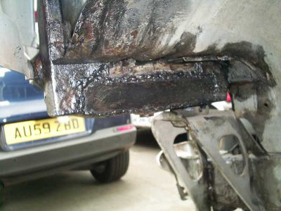

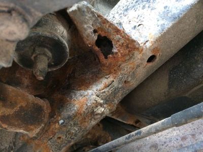

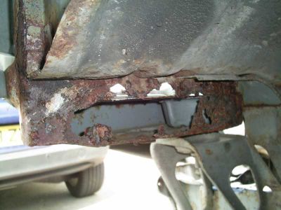

- An example of a severely corroded Jimny 3 underbody. The vehicle was 10 years old with only 60 000 km on the odometer, mostly on paved, salty alpine roads!
This chassis rail is severely weakened
This is a critical structural failure, and prevents the vehicle to be licensed for road use

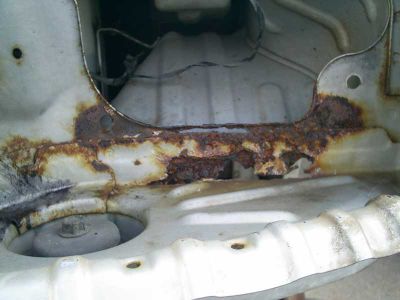

Area behind the head lamps
- Area behind the head lamps is a typical rust point on Jimnys 3, like in this standard example.
View from the front, after the head lamp is removed
View from the back, after the front wheel inner arch liner is removed

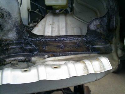

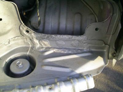

- Significant welding effort is required to properly repair the rust in the tricky place behind the head lamps.
View from the front
After sealing the seams and painting
View from the back

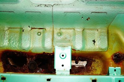

Front floor sections below side door window moving controls
There is a double floor panel in this area of the vehicle (both on the left and on the right side), and it usually rusts from the inside of that body cavity. The only possible preventive measure is to spray wax inside that cavity by accessing it from the underside of the vehicle. However, the only factory drain/access hole is very small and might need widening with a drill or a round filein order to be able to put a spraying hose through it ...
Front right floor section, roughly where right front passenger's right foot stands. Vibrodamping bitumen sheets had been removed prior to taking this picture.

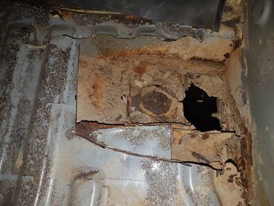

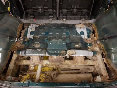

Rear floor section including boot

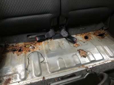

Floor below the rear seat bench, with bitumen vibration damping compound removed
Severely rusted boot floor. Someone desperately applied wax to save it - too late and from the wrong side!

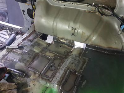

Properly and thoroughly rusted rear floor - the boot floor has already been cut off

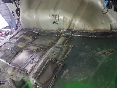

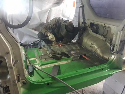

- Salvage efforts on a thoroughly rotten rear floor section
Weld after weld after weld after weld

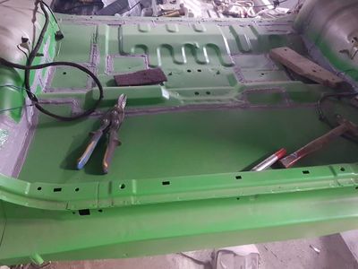

Notice that the entire boot floor has been replaced with a flat sheet
A lot of space has been lost by using a flat boot floor sheet

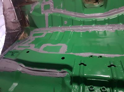

Painting then seam sealing
Close-up after work is done (note: vibrodamping materials are now missing)

- Thoroughly wash and rinse the underbody multiple times, first with a standard automotive detergent and then with a traffic film remover chemical.
- It might be possible to arrange the service of washing the vehicle underbody with some mechanical or body repair workshops which have vehicle service lifts.
- Washing the vehicle underbody when it is lifted 2 meters up in the air provides the best approach for quick and thorough cleaning.
- Let the underbody dry off completely.
- This may take even a few days, depending on current weather conditions.
- Thoroughly check all sections of the underbody, with special attention to factory or additional welds, hidden areas, etc.
- Pay attention to any sign of existing coating becoming delaminated, cracked or peeled off.
- Mark around each found problem area so that you do not miss it in the later process.
- Remove all plugs which seal cavities (like plugs on chassis rails, door sills, etc.).
- Mechanically remove any rust or peeling/cracked old coatings.
- Use hand wire brushes, power drill or angle grinder mounted wire brushes, sand blasting, etc.
- Sand blasting is by far the best / most thorough method for multiple reasons, but is dirty and expensive.
- Pay attention not do damage any cables, hoses, wires, etc.
- Cut out any critically rusted areas and weld in new pieces of metal sheets.
- If there are any localized specks of rust still remaining which can not be eliminated mechanically, you need to eliminate them chemically.
- Use rust elminating acids, like phosphoric acid or even hydrochloric acid.
- Inform yourself of characteristics and hazards of any acid which you intend to use, especially hydrochloric acid!
- Using sand paper in multiple directions, abrade / roughen up any non-sandblasted bare metal surface or painted metal surface which you intend to overcoat.
- Reason: any new coating adheres much better on a rough surface than on a smooth surface.
- This step is especially important in case of bare metal surfaces which had been wire brushed, as wire brushing tends to polish them.
- Clean and degrease the all parts of the underbody which had been exposed to dust or other contaminants during the previous activities and let dry completely.
- Apply one coat of primer paint on all bare metal surfaces.
- This includes any bare metal welds or bare metal panel joins.
- See more info below on best primer types.
- Apply seam sealant to all previously rust-treated areas which have welds or where two metal parts/panels join together.
- It is best to use a polyurethane seam sealant - the more expensive, the better.
- The welds and panel joins should have one layer of cured primer coating over them prior to the application of the seam sealant.
- Now apply the 2nd coat of the same primer paint over all surfaces which had been coated two steps before.
- This includes painting over the cured seam sealant.
- On surfaces with existing healthy protective coating, you might need to apply a solvent to "prepare" the surface for further coatings.
- This depends on the type of existing coating and the type of the anti-chip coating to be applied.
- Apply a stonechip coating of your choice (bitumen-based, synthetic rubber based, polyurethane, etc.) to the entire underbody.
- There are various types of stonechip coatings, with various long-term durability - investigate on your own!
- It is better to use a spray gun instead of brushes because of less chance of having non-covered micro-spots.
- Apply underbody wax over the stonechip coating.
- This is optional, but it provides additional flexible layer of protection, which can self-heal when a rock hits it.
- Apply cavity wax in all cavities (inside the chassis rails, inside door sills, inside doors, inside anything that is hollow.
- Use the holes, which you had exposed earlier when removing the plugs, as entry points.
- Use a spray gun with special long tube with multiple side-facing nozzles on its end.
- After wax spraying is complete and everything else has dried out, return all plugs into position and seal them with raw rubber.
- Take a vacation.
- Preferably in an air spa to clean your lungs of all of the consumed fumes from all these poisons.

Bitumen / tar
- Bitumen / tar based products are the oldest and still the most popular type of general purpose underbody rust protection (predating automobiles).
- They are sometimes called "rubberized coating" (especially in USA), but this classification is not synonymous, as there are synthetic rubber coatings and vinyl coatings which could also be classified as "rubberized".
Advantages:
- Very cheap;
- Simple to apply;
- Have exceptionally high dry film thickness;
- They are therefore quite elastic and even provide certain sound and heat insulation;
- Their elasticity and thickness combined give them exceptional resistance to abrasion and chipping when rock impacts or scraping occurs.
- Can usually also be applied by brush (not just by a forced air gun).
- Impossible to wash off with power washing.
- Excellent choice of underbody coating when attempting to hide existing rust and damage prior to selling the car and presenting the car as "protected from rust" to naive customers.
Disadvantages:
- Do not tolerate heat, so should be avoided in the engine compartment, near the exhaust pipes, etc.
- Such coatings tend to lose their elasticity over time (sooner or later), when they become brittle and develop cracks or (more commonly) start to delaminate from the surface.
- Since they are usually very thick, local cracks and delaminations are usually very hard or even impossible to spot, thus staying undetected for a long time.
- When they crack or delaminate, they trap moisture and salts between them and the surface which they are supposed to protect, rapidly accelerating its demise.
- A metal "protected" by bitumen can rust several times faster than if it had been left bare and exposed to the outside environment!
- Bitumen and tar tend to delaminate more if the underlying surface onto which they had been applied has not been cleaned properly of dust, grease or previous rust and then properly roughened.
- It is impossible to detect a deteriorating / rusting metal surface behind such coatings due to their thickness and elasticity, until most of the metal behind the bitumen gets so rotten that the entire metal panel collapses.
- If applied clumsily or without proper protection of areas which should not be coated (bolts, springs, bushes, pipes, hoses, moving parts like the drive shafts, etc.), they will "gunk up" the underbody and make any future servicing job a very miserable one.
- Many mechanics refuse to service the drive train and the suspension of such vehicles.
- Nobody should blame them for such policy.
- They are extremely difficult to remove, with lots and lots and lots and lots and lots and lots and lots and lots and lots and lots and lots and lots of tedious manual labor required.
- Sand blasting is usually completely ineffective, as bitumen and tar are exceptionally resistant to abrasion.
- Also completely ineffective are any wire brushes and sand papers, as the bitumen rapidly clogs them up.
- Chemical removal methods do work, but they require a lot of liquid and kilometers of rags to wipe the melting gunk off.
- In the end, the most effective method is a chisel and a hammer during as cold day as possible (to have the bitumen as brittle as possible), with inevitable damage to the metal due to chiseling.
- Pro tip: It is best to delegate the bitumen removal job to convicts, prisoners of war or feminists.
- An example video from USA says more than a thousand pictures, each of which says more than a thousand words.
- The video portrays the fate of a 4WD vehicle which had been "protected" by a bitumenous rust proofing coating product called "Ziebart", which is quite popular in certain parts of USA.
- That coating had been applied to that vehicle when the vehicle was new.
- The author stated that the vehicle was less than 10 years old when the video was made, but they did not state its exact age (guessing somewhere between 5 and 8 years old).
Conclusion:
- Strongly avoid using bitumen or tar based underbody coatings, due to high risk of accelerated failure and the extreme difficulty of removing the coating.
- While the applied bitumen / tar coating typically looks pristine for years and years after the initial application, the protected Cinderella's carriage might suddenly turn to a pumpkin after the invisible rusty deadline rings!
- The only parts of the underbody where a bitumen based coating might make sense is the wheel arches, which are the most stone-chip exposed areas of the underbody by far, and also create the most noise when driving on gravel or through mud.
- But even for this application it is better to use something more expensive.

Many people who restore old timer vehicles take the following procedure:
- Wash the underbody and the cavities.
- Completely dismantle the vehicle.
- Cut out any rotten parts of the cabin and the chassis and patch weld them.
- Sand blast the chassis (if it exists), the entire cabin and most suspension parts.
- Spray the the entire cabin (except its underside) with 2K "normal build" epoxy primer in two coats (with the application of a polyurethane seam sealant in between to most panel joints and all welds).
- Spray the entire cabin (except its underside) by a top coat.
- Spray or brush the underside of the cabin with a 2K "high build" epoxy primer in two coats (with the application of a polyurethane seam sealant in between to most panel joints and all welds).
- Spray or brush the underside of the cabin with an underbody wax.
- Spray the cavities in the cabin with a cavity wax.
- Some people take the sand blasted chassis, suspension arms, axles and other "thick metal" to be hot dip zinc plated.
- After zinc plating, they spray or brush zinc plated parts with underbody wax, including cavity wax for the insides of the chassis.
- If no zinc plating has been performed:
- They spray or brush the chassis and suspension parts with two layers of 2K "high build" epoxy primer paint (with the application of a polyurethane seam sealant in between to all welds).
- They spray them with underbody wax, including cavity wax for the insides of the chassis.
- The described method provides more than enough decades-long underbody rust protection for on-road old timer vehicles.
- Either the zinc plating or the epoxy paint will easily withstand all usage scenarios through which such vehicles will go through during the next decades to come, especially with wax on top of them.
- However, these layers of protection are not enough for all-terrain vehicles which are used in all-terrain duty.
- An additional anti-stone chip layer is required between the epoxy paint and the wax on all sections of the underbody and suspension parts which have relatively high risk of abrasion.
