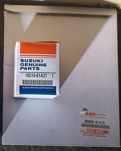

Original Suzuki filters
The part numbers of Suzuki's genuine cabin / pollen filters for Jimnys are:
  • 95860-81A00
  • 95860-81A01
  • 95860-81A10
    • This one allegedly contains charcoal (carbon) particles.
All three should be mutually compatible (same dimensions etc.) and the differences are probably "only" in the filtering quality / capability.
Required dimensions for a compatible filter are:
  • Length : 213-217 mm
  • Width : 183-188 mm
  • Height : 20 mm
