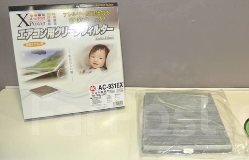

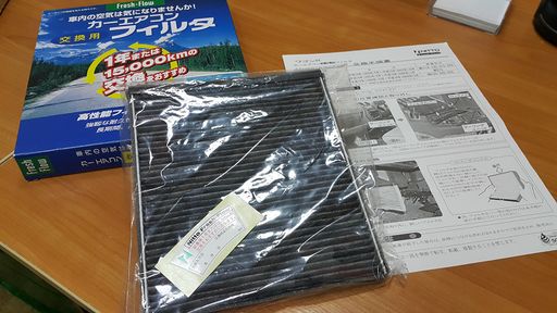

Known filters with charcoal particles (add others if you find them):
New cabin air filter Nitto F801
New cabin air filter Vic AC-931EX
