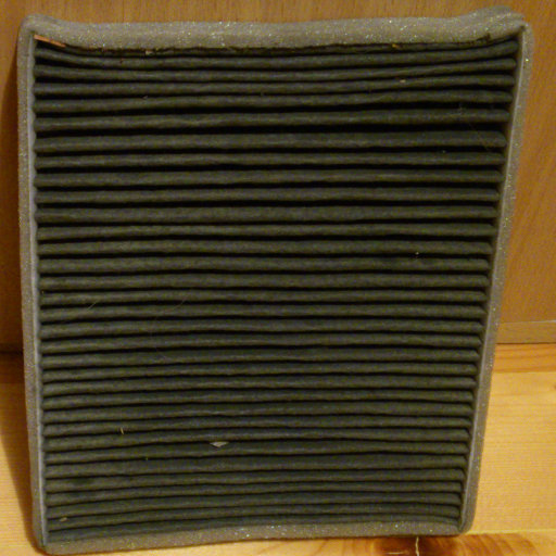

Used old cabin filter with charcoal particles
  • This is an example of a five year old (heavily used) cabin filter of unknown manufacturer, which was removed from a Jimny 3.
    • This is a filter which contains charcoal particles, so it is normal to look "dirty" / greyish, but not this much.
  • That picture was unfortunately taken just after the leaves and grit were brushed off off from the filter.
  • The weight of that used dirty filter was around 800 grams!

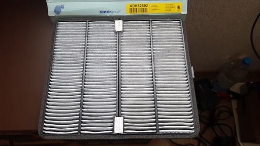

Brand new Blue Print ADK82502 cabin filter - two-piece specimen with a bit of carbon particles
Compatible aftermarket filters which truly contain proper charcoal (carbon) particles in a significant amount are quite rare (and usually significantly more expensive).

  • Blue Print's ADK82502 filter used to be a two-part construction with embedded carbon (charcoal) particles.
  • However, there have been recent reports of "sightings" of the same filter model which contained a lot less charcoal particles, and also of a plain ordinary paper filter in a single-part case.
  • So, if buying this filter model (or any other filter model for that matter), double-check with the seller on what exact filter is in the box!

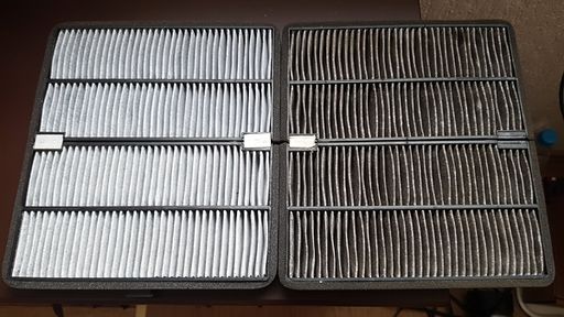

  • Two "same" cabin filters Blue Print ADK82502.
  • The amount of carbon particles in the newer (left) filter is significantly less than in the older (right) filter.
  • There have also been confirmed sightings of this filter model which had a pure white color, without a single carbon particle in it.
  • Obviously the amount of carbon particles in this filter model varies widely from batch to batch!
  • TOP: Filter Mahle LA 95 - ordinary paper, single-piece construction.
  • LEFT: Blue Print ADK82502, newer production date.
  • RIGHT: Blue Print ADK82502, older production date.

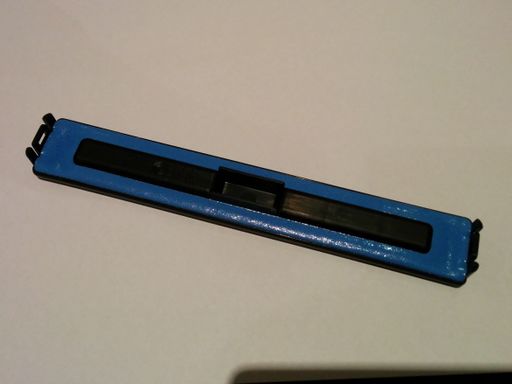

Genuine cabin filter cover
  • You may wish to consider buying a spare cabin filter cover at the same time.
  • The part number of Suzuki's genuine cabin / pollen filter cover for Jimnys is: 95423-81A01
  • The suitable cover is also offered in BigJimny Shop.
It is common to break the filter cover when removing it as the plastic becomes brittle.

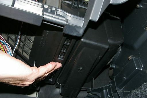

Passenger footwell
  • Here is the filter cover, up underneath the dashboard on the passenger side of the vehicle
Here is the cover in the footwell

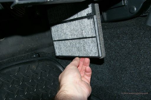

Inserting the cabin filter
  • If you have a UK Jimny, you are more than likely to find an empty hole now (full of bits of leafs).
  • Simply insert the cabin filter.
