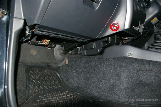

  • Here is the filter cover, up underneath the dashboard on the passenger side of the vehicle
Here is the cover in the footwell

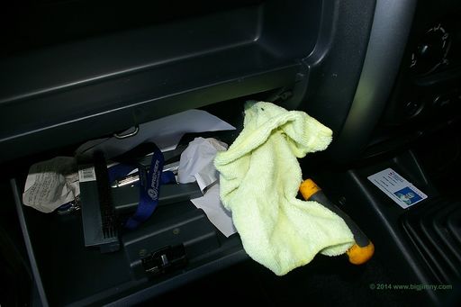

  • First remove the glovebox.
  • This is done by flexing the sidewalls so the plastic retaining lugs can drop past the edge of the fascia.
  • Lower the whole glovebox away.
  • I am using a screwdriver with the end protected by a cloth to stop it marking the fascia, as I use it to prise away the retaining lugs.

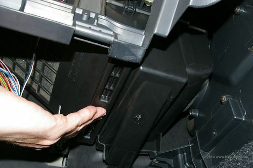

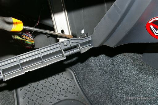

Cabin filter cover retaining clips

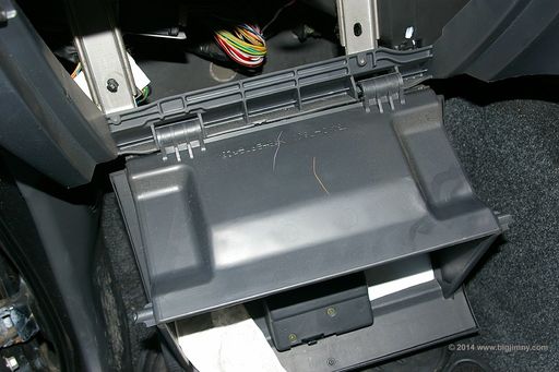

Glovebox dropped open

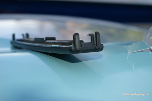

  • The filter cover is retained by small clips on the end.
  • The tip of the scewdriver points to where the clip is (hidden).

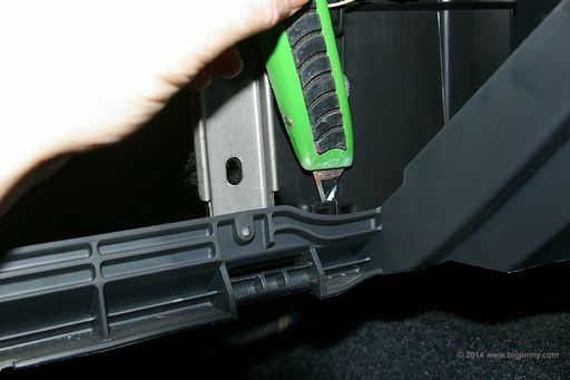

Using blade to prise clip
  • Warm the plastic filter cover.
  • Either use a hairdrier or allow the car's own heater to warm the car (on re-circulate setting).
  • If the plastic is cold it is more likely to fracture.
  • Insert a small blade into the filter retaining lugs and gently prise it away from the edge of the moulded catches on the heater body.
  • Do this a bit at a time alternating front and back.
