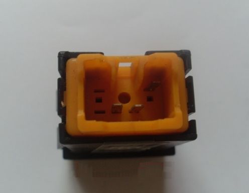

- In-cabin front fog lamp switch (P.N. 37270-76J00)
This should be the pinout of the switch P.N. 37270-76J00:
- Pins 1 and 2 are earth.
- Pin 3 is unused.
- Pin 4 is the output to the fog lamp relay.
- Pins 5 and 6 are the "+ve" feed - these are wired to the lighting circuit in the vehicle, as it is not allowed to have the fog lamps on without having the main head lamps on.
- Pin 5 is the power that goes through to the fog lamps.
- Pin 6 is just the feed to illuminate the switch itself.

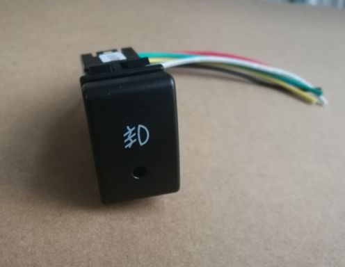

If you are using some 3rd party 3-wire wiring to connect to the switch P.N. 37270-76J00, then wire it like this:
- Earth - Pins 1 and 2 (connect to BOTH)
- From relay - Pin 4
- From main head lamp circuit - Pins 5 and 6 (connect to BOTH)
- In-cabin front fog lamp switch (it's P.N. is unknown), removed from an unknown Suzuki vehicle
