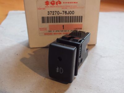

- A rectangular button / switch for the driver's console;

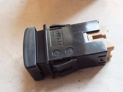

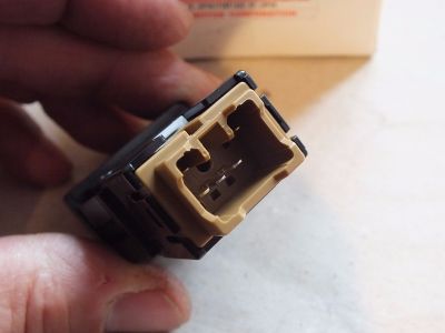

- In-cabin button / switch P.N. 37270-75F10;

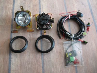

Official advertising image
All the contents of the set

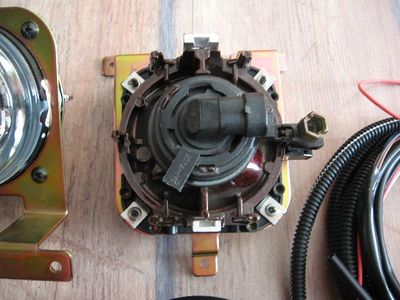

Fog lamp and bracket - front view
Fog lamp and bracket - rear view
Fog lamp bezels for flush fitting in bumper holes

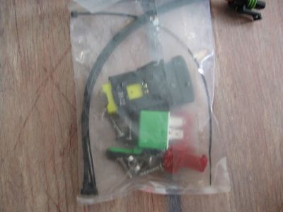

Small parts - switch, fuse, screws, etc.

- One in-cabin console switch model;

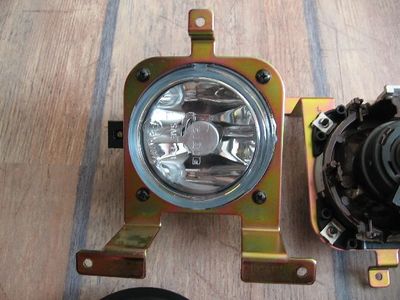

- Front fog lamp P.N. 35500-74F50 with bracket P.N. 35526-81A01, taken from 1st model front bumper

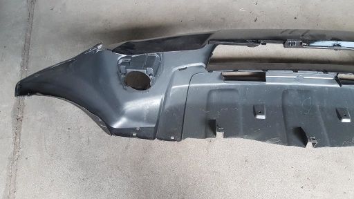

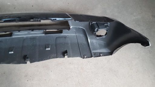

- 3rd model front bumper - view from inside - enlarge the pictures and note the screw holes in the integrated front fog lamp brackets, to which the fog lamps directly attach
Left part
Right part

- 3rd model front bumper already comes with a pair of "blank" bezels attached in the place of fog lamps.
- The "proper" bezels look exactly like the "blank" bezels, but only with a pre-cut hole for the fog lamps.

- You can also buy one of complete fog lamp retrofit kits mentioned earlier in the article.
- That way you will eliminate any risk of missing any of needed components.
- The wiring harness kits appear to be separate for the fog lamps and for the in-cabin switch.
- The wiring harness kit in the engine bay for the fog lamps is P.N. 99000-990YZ-A05.
- This kit also includes a 15A in-line fuse and a plug to the relay, but not the relay itself.
- It is currently not known if this kit is compatible with every Jimny 3 revision and every fog lamp model used!
- However, it is known to be compatible with Jimnys type 1-4 and fog lamps model 35500-74F50.

- There are two types of wiring connectors for front fog lamps in Jimnys 3.
- The first connector type was used in all Jimnys 3 type 1-5 (which originally came with 1st model front bumper, from 1998 to approx 2005).
- This connector type is compatible only with front fog lamp model 35500-74F50.
- Other fog lamp models can be connected to it through a suitable connector adapter 36813-54G20.
- The second connector type was used in all Jimnys 3 type 6-12 (which originally came with 2nd and 3rd model front bumper, from approx 2005 to 2018).
- This connector is directly compatible with all fog lamp models 35500-63J0X.
- It is incompatible with front fog lamp model 35500-74F50 (which was not meant for 2nd and 3rd model bumpers anyway, since no brackets for that combination are available).
- However, a required el. connection could probably be made by cutting the connectors off and soldering the wires directly.

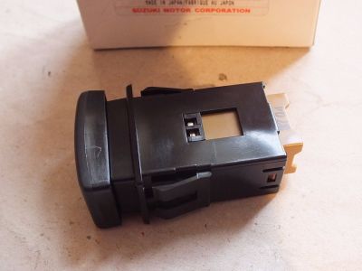

- The switch appears to exist in two editions:
- Older model P.N. 37270-75F10;
- This model presumably fits Jimnys 3 with older (1998-2005) style interior and in-cabin console.

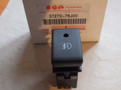

- Newer model P.N. 37270-76J00;
- This model presumably fits Jimnys 3 with newer (2005-2018) style interior and in-cabin console.
- Both switch editions appear the same - add info about the differences and compatibility if you know them!
- The switch is a "permanent press-in" type - after you press it, it stays pressed in until pressed again. The switch also contains a small light indicator which is lit when the switch is pressed in.
- It appears that the same switch has been used for the front fog lamps in Suzuki Vitara 2 (a.k.a. "Grand Vitara") (1998-2005).

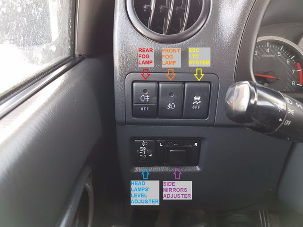

- In a Jimny 3, the switch is located next to rear fog lamp switch in a three-switch console cluster.
- The cluster is located to the left of the steering wheel (for LHD vehicles) or to the right of the steering wheel (for RHD vehicles).
- In-cabin front fog lamp switch (P.N. 37270-76J00)
- In-cabin front fog lamp switch (it's P.N. is unknown), removed from an unknown Suzuki vehicle

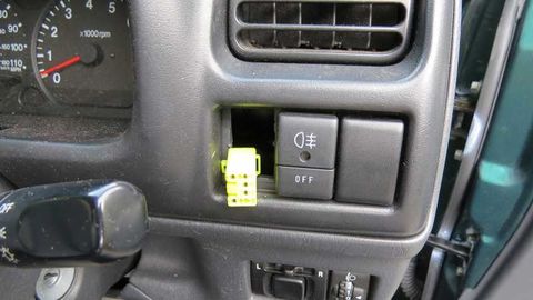

How to install the switch in the console
- Use a flat-bladed plastic (not metal!) tool for the removal, in order to avoid damaging or scratching anything.
- It is best to prise an object off a little bit at each side at a time.
For pre-2006 Jimnys 3 (with 1998-2005 interior)
- Leverage the tool directly against the blank itself in order to prise it off.
- If the connector for the front fog lamp switch is already present behind in the hole, just connect it to the your new front fog lamp switch.
- Test if the switch works.
- Just push the newly connected switch into the opening - it will simply click in.
