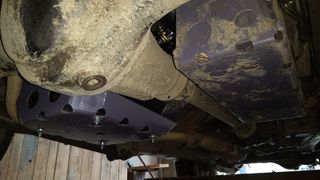

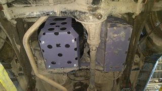

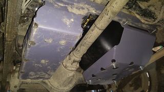

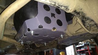

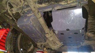

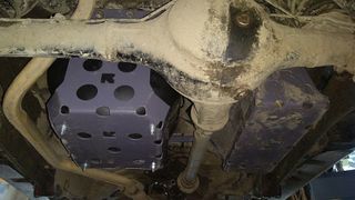

Solution 1 - from Rtech.com.pl
- A Polish company has done precisely this - they made a custom small petrol tank for Jimnys, together with an adjacent carrier to hold an LPG fuel tank of your choice.
- The custom petrol tank and the adjacent LPG holder frame are made to be bolt-on compatible with the factory petrol tank mounting points on the chassis.
- Also, the custom petrol tank readily accepts the fuel pump and the fuel level gauge from the factory petrol tank.
- Here is the product on their web site.
- They sell the product on this Polish ebay-alike web site.
- In this solution, the petrol fuel tank capacity is 22 l, while the remaining available space provides for an installation of a cylindrical LPG tank of the following approximate dimensions: diameter ~360 mm and length ~ 340 mm.
- The manufacturer of this solution recommends a suitable LPG fuel tank with a capacity of 28 l (and weight of 11 kg), made by manufacturer Elpigaz (or Grodkowskie Zakłady Wyrobów Metalowych S.A), model ZGC360H028S2M6STA9K.
- This is the web page where this LPG fuel tank model is listed, and these are its certificates.
- Edition without reinforced bottom protectors for the LPG and petrol tanks
- Edition with reinforced bottom protectors for the LPG and petrol tanks
- How it looks when installed - picture gallery 1 of 2
- How it looks when installed - picture gallery 2 of 2
