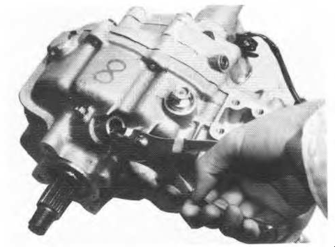

Figure 01 - removing the shifter
  • First you have to get both transfer boxes onto the workbench.
  • Drain the oil - leave it to drain for a while, you will get oil everywhere anyway!
  • Remove the mounting points.
  • Remove the gear lever, if this was not done when removing it from the vehicle.
    • This is achieved by removing the rubber gaiter and by pressing and rotating the retaining plate.

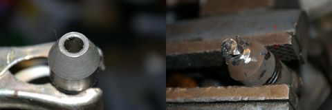

Figure 05 - removing the speedo drive
  • Now remove the speedometer driven gear.
  • This is the mount where the speedo cable was attached.
  • Make sure the little 10 mm bolt is fully removed.
  • You may be lucky and be able to pull out the gear with mole grips.
  • But it may have corroded into place in which case you are in trouble.
  • I found that by grinding (with the Dremel) a small groove in the top of the gear and then insert a small chisel in the groove and gently hit the gear attempting to rotate it and break the corrosion.
  • This picture is not clear, the transfer case is upside down, the speedo drive is just below the painted number 8 on the picture.

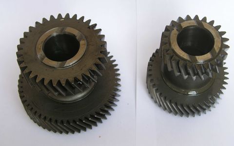

Figure 11 - intermediate gears (410 LEFT, 413 RIGHT)
  • The intermediate shaft is now free to be removed.
  • Once you have disassembled both you should have the gears as in this picture.

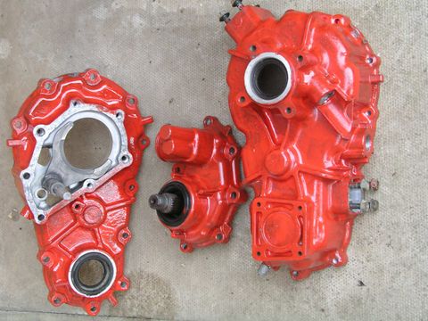

Figure 12 - painted transfer case
  • Whilst the gears are off being cut and shut you can busy yourself preparing the rest of the box.
  • A coat of paint will not go amiss, and a lobster can only be RED! (unless its Blue – I changed colour the second time around).

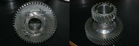

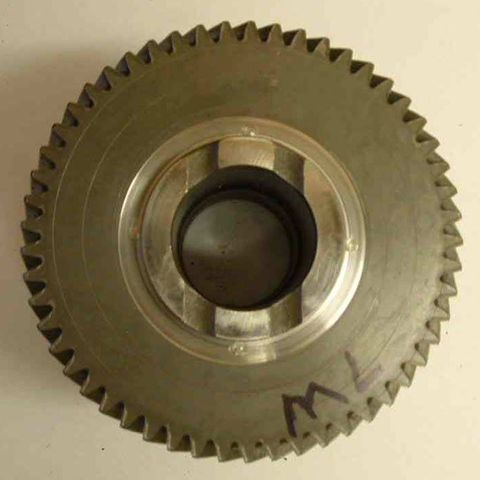

Figure 15 - gears before welding
  • By now you should have also built your replacement intermediate gear.
  • The manufacturer of my gear used pins along the gear shear line to reinforce the joint.
  • This picture shows the gears before welding.
Figure 16 - gears after welding
  • This picture shows the welded gears.

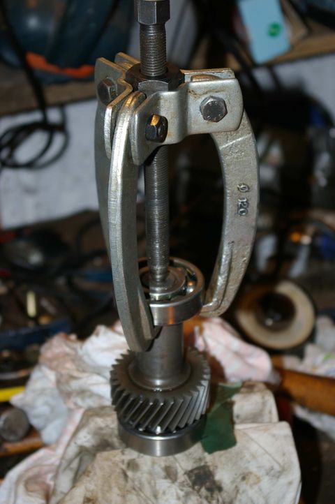

Figure 17 - bearing puller
  • If you are changing the bearings you need to pull out the old bearings and push on the new.
  • The bearing types are given in the table earlier in this document.
  • The output shaft bearings are simply pulled off the shaft.
  • This picture shows a cheap bearing pulling being put to use.
  • Putting the bearings back on requires some care.
  • They can be pressed or driven on, but also if you use some ingenuity you can use the threads and flanges to push them into place.

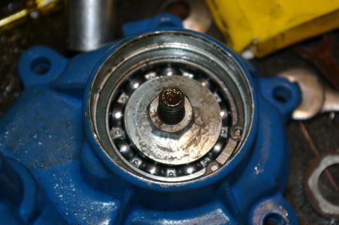

  • The front case bearing is more hidden.
  • You need to pull out the oil seal and remove the large circlip inside.
  • Using a soft mallet you can then drive out the shaft.
  • It will then be possible to drive the old bearing out from behind.
  • Putting the new bearing in requires some care.
  • I used a metal plate behind the case and put a bolt through with some large washers and tightened the bolt, pulling the bearing into position.
Figure 19 - front case bearing

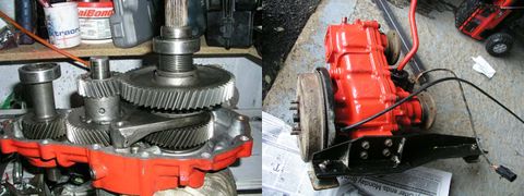

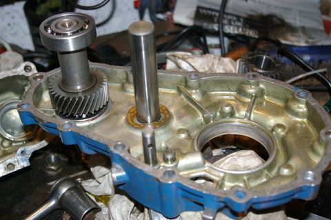

Figure 20 - input shaft in position

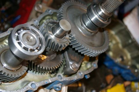

Figure 21 - all shafts in position
Figure 22 - you did include the shift fork when putting the output shaft!

  • Then fit the intermediate shaft and finally the output shaft
  • Remember to include the shift fork as you put the output shaft in place.
    • There is not enough room to add it afterwards!
Figure 23
  • Now the two cases can be recombined.
  • Hopefully you have cleaned the mating surfaces up already when you were checking the end float.
  • Make sure that the gaskets, shims and thrust bearings are all in place.
  • You may need to persuade them to stay put with a dab of silicon gasket.
  • Squirt some gearbox oil over the bearings and moving parts to help everything when it spins up for the first time.
  • The cases should then push together with a firm push.
  • Bolt on the front case section.
  • Reinsert the 4WD switch and ball bearing.
Figure 24 - welding up the speedo drive
  • If you are building the Transfer Case for an SJ you will need to reinsert the speedometer drive at this point.
  • However, if you are building it for a Jimny, then you will have no need for the mechanical drive.
  • However you will need to put something in to stop it leaking oil.
  • I simply took the SJ speedo mount and welded up the end and silicon gasket sealed it into place.
  • The left picture shows the starting point and the right picture shows my blob welding part way through (I cleaned it up with an angle grinder so I could spot the holes).
