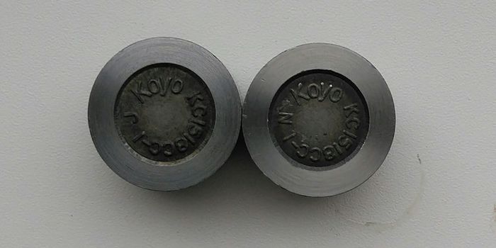

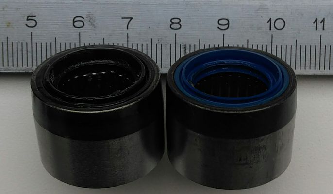

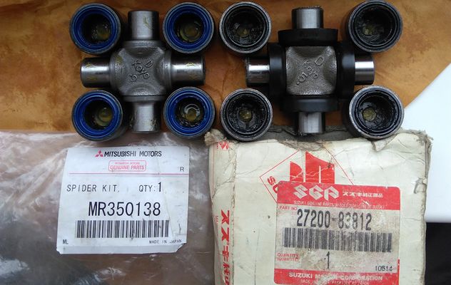

| + | === More info on universal joint Koyo <font face="courier">"KC1518CC-1"</font> ===  | ||
| + | * Original Mitsubishi part numbers <font face="courier">MR350138</font> and <font face="courier">MR196837</font> use ''more-or-less the same'' universal joint <font face="courier">Koyo "KC1518CC-1"</font>.  | ||
| + | * Those Mitsubishi part numbers are factory fitted universal joints on their Pajero 2 vehicles (and possibly Pajero 1 as well).  | ||
| + | ** Therefore, they are also high quality parts.  | ||
| + | * Reasons why they are "more-or-less the same" as the Koyo joints used in <font face="courier">Suzuki 27200-83812</font>:  | ||
| + | ** All three universal joints have the same dimensions and therefore are mutually interchangeable in practice.  | ||
| + | ** <font face="courier">Mitsubishi MR350138</font> also has no grease nipple like Suzuki, but it omits the dust/water boots/seals on the universal joint body, which the Suzuki has. On the other hand, Mitsubishi joint's end caps have a seal with double lips, while Suzuki's joint's caps have a seal with a single lip.  | ||
| + | ** <font face="courier">Mitsubishi MR196837</font> comes with a grease nipple, which fits into a factory drilled hole in one of the four caps. It has no boots on the joint body. The seals in the caps appear to be different than in <font face="courier">Mitsubishi MR350138</font>.  | ||
| + | ** Mitsubishi <font face="courier">MR196838</font> is allegedly identical, apart that it comes without a grease nipple and has no hole for it in any of the four caps.  | ||
| + | * Conclusion: Either of those two Mitsubishi universal joints can be used instead of original Suzuki universal joints and are considered to be high quality alternatives, which are superior to most aftermarket replacements.  | ||

More info on universal joint Koyo "KC1518CC-1"
- Original Mitsubishi part numbers MR350138 and MR196837 use more-or-less the same universal joint Koyo "KC1518CC-1".
 - Those Mitsubishi part numbers are factory fitted universal joints on their Pajero 2 vehicles (and possibly Pajero 1 as well).
- Therefore, they are also high quality parts.
 - Reasons why they are "more-or-less the same" as the Koyo joints used in Suzuki 27200-83812:
- All three universal joints have the same dimensions and therefore are mutually interchangeable in practice.
 - Mitsubishi MR350138 also has no grease nipple like Suzuki, but it omits the dust/water boots/seals on the universal joint body, which the Suzuki has. On the other hand, Mitsubishi joint's end caps have a seal with double lips, while Suzuki's joint's caps have a seal with a single lip.
 - Mitsubishi MR196837 comes with a grease nipple, which fits into a factory drilled hole in one of the four caps. It has no boots on the joint body. The seals in the caps appear to be different than in Mitsubishi MR350138.
 - Mitsubishi MR196838 is allegedly identical, apart that it comes without a grease nipple and has no hole for it in any of the four caps.
 - Conclusion: Either of those two Mitsubishi universal joints can be used instead of original Suzuki universal joints and are considered to be high quality alternatives, which are superior to most aftermarket replacements.
- Suzuki 27200-83812 and Mitsubishi MR350138 - side by side comparison
