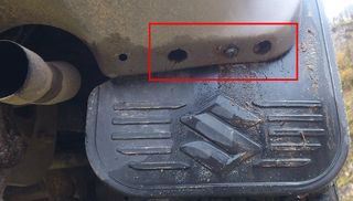

If you install rear mud flaps, it is advised to drill two holes (fi=30 mm) in the bottom of the rear bumper, behind each mud flap (two holes per each side).
= Issues with rear mud flaps =
That will enable the mud and grit, which regularly accumulates in the rear bumper behind the mud flaps, to drain off or be flushed out when power washing the vehicle. Otherwise, it is almost impossible to flush out.
The holes will be invisible to the general public.
That will enable the mud and grit, which regularly accumulates in the rear bumper behind the mud flaps, to drain off. Otherwise, it is almost impossible to flush out.
