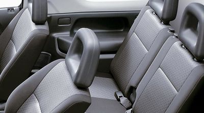

| + | === ISOFIX anchors === | ||
| Line 127: | Line 138: | ||
* Newer ISOFIX equipped rear seats and older non-ISOFIX rear seats (''if made after 2005'') are fully bolt-on compatible. | * Newer ISOFIX equipped rear seats and older non-ISOFIX rear seats (''if made after 2005'') are fully bolt-on compatible. | ||
** Therefore, it is dead simple to swap them between vehicles. | ** Therefore, it is dead simple to swap them between vehicles. | ||
| + | === Compatible child seats and refridgerators === | ||
* Suzuki offers various models of certified child seats, as well as portable car refridgerators, both for ISOFIX equipped and for non ISOFIX Jimny rear seats. | * Suzuki offers various models of certified child seats, as well as portable car refridgerators, both for ISOFIX equipped and for non ISOFIX Jimny rear seats. | ||
* Details about those child seats and refridgerators are written in the wiki article [[Accessories for Jimny (genuine Suzuki)|'''"Accessories for Jimny (genuine Suzuki)"''']] (look in the section "Interior cargo management"). | * Details about those child seats and refridgerators are written in the wiki article [[Accessories for Jimny (genuine Suzuki)|'''"Accessories for Jimny (genuine Suzuki)"''']] (look in the section "Interior cargo management"). | ||
| + | * There should be a wide variety of compatible aftermarket offerings as well. | ||
| + | === Recess for the rear seat belt buckles === | ||
| + | * Another useful modification which was introduced with ISOFIX equipped rear seats is that the rear seat bench has a center hole cut-out to allow both rear seat belt buckles to be easily tucked in when not used, so that they do not stick out from the floor all the time. | ||
| + | * Compare the pictures of the rear seat bench in the chapter about seat head rests to get the picture of you are reading about. | ||
| + | It has been confirmed in practice that older rear seat benches can be relatively easily modified to have the same functionality: | ||
| + | # First remove the rear seat bench from the vehicle. | ||
| + | #* Just put your hands between its front end and the floor and strongly pull upwards. | ||
| + | # Now take off the upholstery from the rear seat bench. | ||
| + | #* The upholstery is held by many strong and curled wire laces - just spread them out with pliers and toss them away. | ||
| + | #** You can replace those nasty wire laces with plastic cable ties upon later refitting. | ||
| + | # Then cut out a larger / longer center hole in the bench sponge for the rear seat belt buckles. | ||
| + | # Now comes the most complicated step - cut out and re-stitch part of the upholstery so that it matches the larger hole cut-out in the bench sponge. | ||
| + | #* If this is too complicated for you, then take the bench to a professional vehicle upholstery fitter - this is easy for them. | ||
| + | # Finally, dress the modified upholstery back onto the modified seat bench. | ||
| + | # Install the rear seat bench back into the vehicle and enjoy life. | ||
| Line 136: | Line 171: | ||
| + | * Jimnys 3 used to have the same seat head rest model (hollow appearance, like a doughnut) from 1998 to 2012. | ||
* Completely redesigned seat head rests were introduced in year 2012 and used until the end of production in 2018. | * Completely redesigned seat head rests were introduced in year 2012 and used until the end of production in 2018. | ||
* New head rests are smaller and have no hole in the middle. | * New head rests are smaller and have no hole in the middle. | ||
| Line 141: | Line 177: | ||
* In contrast to the old fixed rear seat head rests, new rear seat head rests can be lowered (slided) all the way down so that the top of the head rest is on the same level as the top of the seat. | * In contrast to the old fixed rear seat head rests, new rear seat head rests can be lowered (slided) all the way down so that the top of the head rest is on the same level as the top of the seat. | ||
** This is an especially useful functionality, and should be the default rear head rest height when not used. | ** This is an especially useful functionality, and should be the default rear head rest height when not used. | ||
| − | ** When the rear head rests are in their lowest slided down position, they enable | + | ** When the rear head rests are in their lowest slided down position, they enable: |
| + | **# Significantly better visibility through the rear window; | ||
| + | **# Much easier (un)loading of cargo from the rear door opening to the rear seats; | ||
| + | **# Forward folding of the rear seats all the way down without having to remove the head rests first. | ||
| Line 148: | Line 187: | ||
* Reason: Significantly different thickness of the head rests' rods which go into the seats themselves. | * Reason: Significantly different thickness of the head rests' rods which go into the seats themselves. | ||
** Old (hollow) head rests have much thicker rods than new head rests. | ** Old (hollow) head rests have much thicker rods than new head rests. | ||
| + | <gallery widths="400px" heights="270px" class=center> | ||
| + | Suzuki Jimny 3 - seats - 2005-2012 - A01.jpg|Typical cloth seats and common model head rests on Jimnys 3 produced from 2005 to 2012 | ||
| + | Suzuki Jimny 3 - seats - 2012-2018 - A01.jpg|Premium full leather seats and common model leather head rests on Jimnys 3 produced from 2012 to 2018 | ||
| + | </gallery> | ||

Remarks on seat head rests
- Jimnys 3 used to have the same seat head rest model (hollow appearance, like a doughnut) from 1998 to 2012.
- Completely redesigned seat head rests were introduced in year 2012 and used until the end of production in 2018.
- New head rests are smaller and have no hole in the middle.
- New front seat head rests are significantly titled forwards, what some people find quite counter-ergonomic.
- In contrast to the old fixed rear seat head rests, new rear seat head rests can be lowered (slided) all the way down so that the top of the head rest is on the same level as the top of the seat.
- This is an especially useful functionality, and should be the default rear head rest height when not used.
- When the rear head rests are in their lowest slided down position, they enable:
- Significantly better visibility through the rear window;
- Much easier (un)loading of cargo from the rear door opening to the rear seats;
- Forward folding of the rear seats all the way down without having to remove the head rests first.
- The best combination (from the perspective of ergonomics and functionality) would be to have old front head rests and new rear head rests.
- Unfortunately, new and old seat head rests are not interchangeable.
- Reason: Significantly different thickness of the head rests' rods which go into the seats themselves.
- Old (hollow) head rests have much thicker rods than new head rests.
