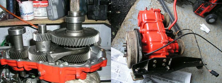

[[File:Transfer box conversion to Rock Lobster guide - figure 01.png|thumb|left|480px|Figure 01 - removing the shifter]]
[[File:Transfer box conversion to Rock Lobster guide - figure 01.png|thumb|left|272px|Figure 01 - removing the shifter]]
* First you have to get both transfer boxes onto the workbench.
Line 225: Line 228:

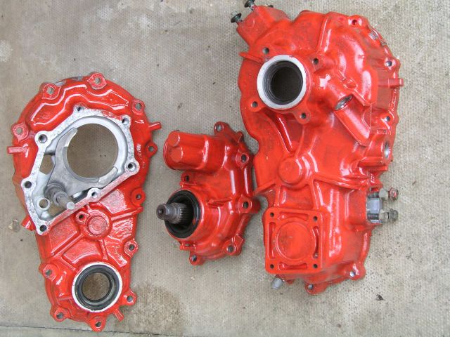

* Now remove the speedometer driven gear.

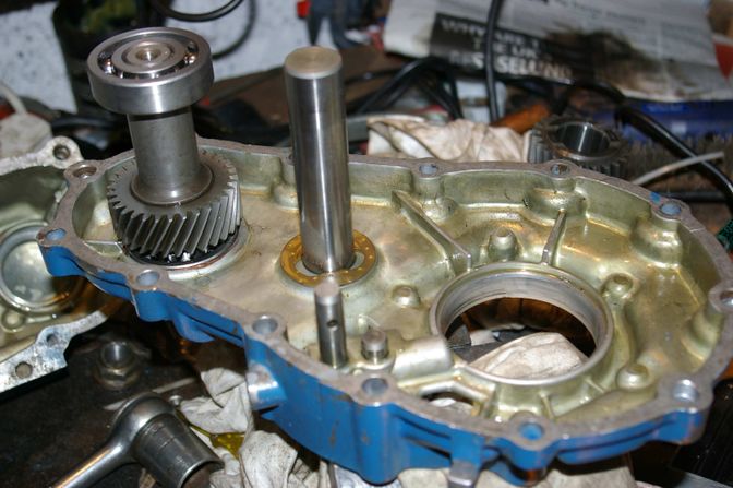

* At this point you will be able to tap the output shaft out of the case.
Line 276: Line 279:

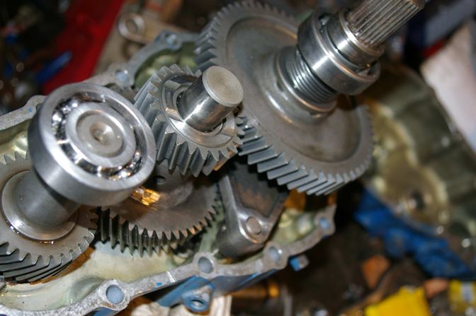

[[File:Transfer box conversion to Rock Lobster guide - figure 11.jpg|thumb|left|480px|Figure 11 - intermediate gears (410 LEFT, 413 RIGHT)]]
[[File:Transfer box conversion to Rock Lobster guide - figure 11.jpg|thumb|left|640px|Figure 11 - intermediate gears (410 LEFT, 413 RIGHT)]]

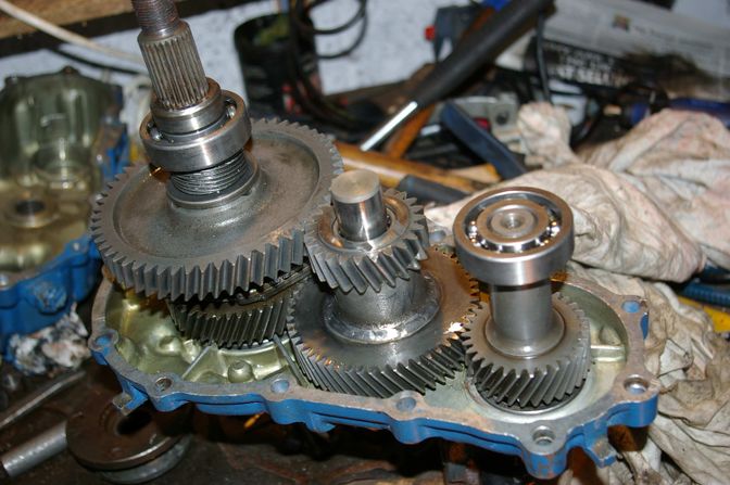

* The intermediate shaft is now free to be removed.
Line 292: Line 295:

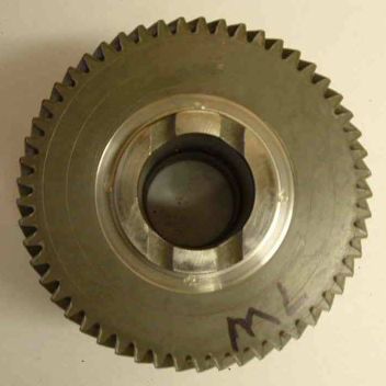

* Whilst the gears are off being cut and shut you can busy yourself preparing the rest of the box.
Line 299: Line 302:

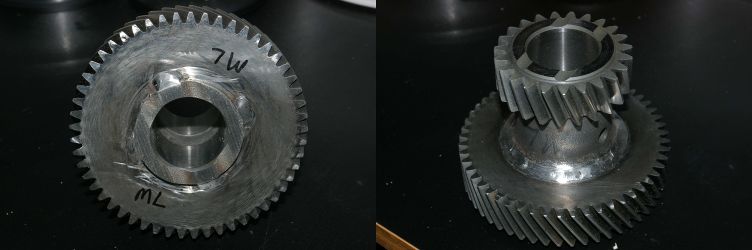

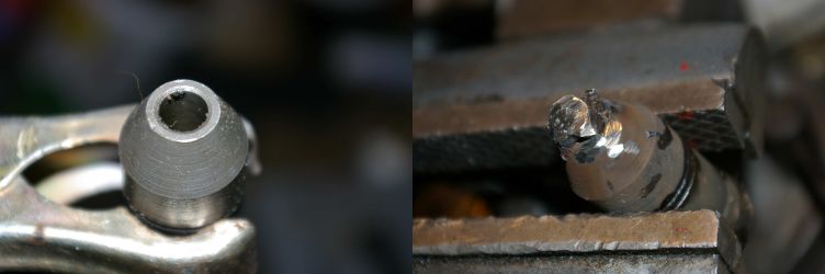

[[File:Transfer box conversion to Rock Lobster guide - figure 13.jpg|thumb|left|480px|Figure 13 - comparing the two output shafts]]
[[File:Transfer box conversion to Rock Lobster guide - figure 13.jpg|thumb|left|640px|Figure 13 - comparing the two output shafts]]

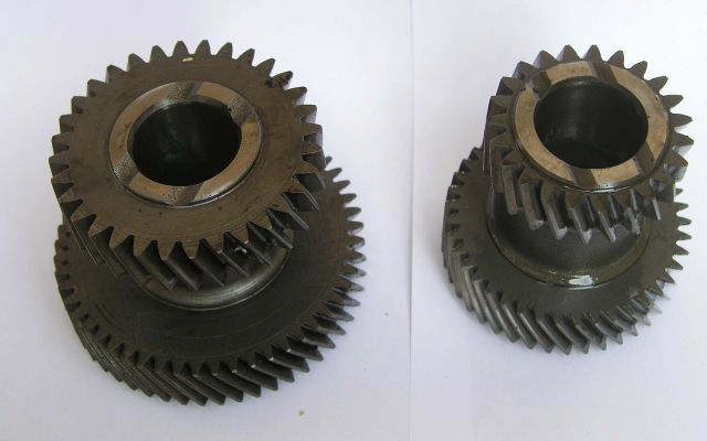

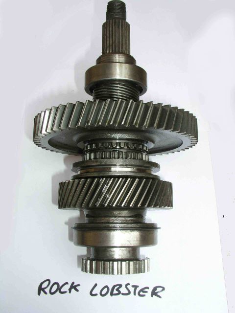

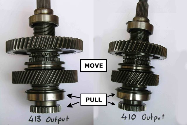

* You also need to combine the gears from the 410 output shaft and the 413 output shaft to create a new Rock Lobster output shaft.
Line 317: Line 320:

* By now you should have also built your replacement intermediate gear.
Line 325: Line 328:
[[File:Transfer box conversion to Rock Lobster guide - figure 16.jpg|thumb|left|480px|Figure 16 - gears after welding]]
[[File:Transfer box conversion to Rock Lobster guide - figure 16.jpg|thumb|left|752px|Figure 16 - gears after welding]]
* This picture shows the welded gears.
Line 339: Line 342:

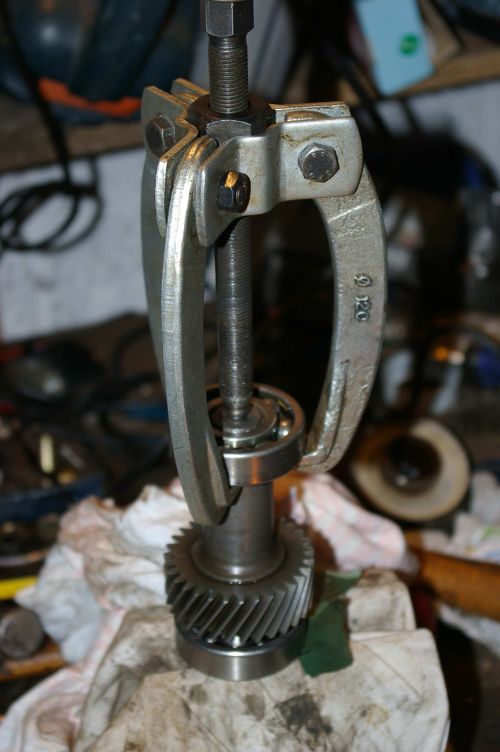

* If you are changing the bearings you need to pull out the old bearings and push on the new.
Line 350: Line 353:

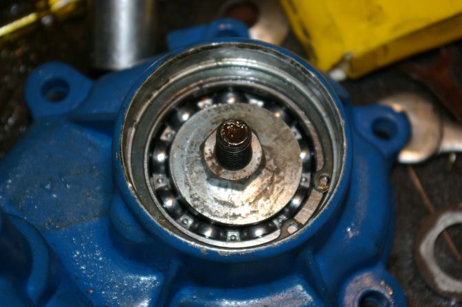

* The front case bearing is more hidden.
Line 356: Line 359:
* Using a soft mallet you can then drive out the shaft.
* It will then be possible to drive the old bearing out from behind.
<br clear=all>
[[File:Transfer box conversion to Rock Lobster guide - figure 19.jpg|thumb|left|672px|Figure 19 - front case bearing]]
* Putting the new bearing in requires some care.
* I used a metal plate behind the case and put a bolt through with some large washers and tightened the bolt, pulling the bearing into position.
  • The intermediate shaft is now free to be removed.
  • Once you have disassembled both you should have the gears as in this picture.
Modifications
  • Now is the time to get the intermediate gears cut and welded.
  • You need to connect the larger gear on the 410 to the smaller gear on the 413.
  • As I said previously I got someone else to do this bit.
Figure 12 - painted transfer case
  • Whilst the gears are off being cut and shut you can busy yourself preparing the rest of the box.
  • A coat of paint will not go amiss, and a lobster can only be RED! (unless its Blue – I changed colour the second time around).
  • You also need to combine the gears from the 410 output shaft and the 413 output shaft to create a new Rock Lobster output shaft.
  • Take the 413 output shaft and remove the spring clip from the gear shown at the bottom of the picture.
  • Be aware that there is a small needle bearing inside the end of the shaft.
    • Be careful NOT to rest the end of the gear puller on this bearing as it will push it in or even break it.
  • Pull this gear off, then pull off the bearing (also the one at the bottom of the picture).
  • Repeat for the 410 shaft.
Figure 14 - Rock Lobster output shaft
  • Put the gear from the 410 shaft onto the 413 shaft and press on the bearing and the end gear, replacing the spring clip.
  • You should end up with the gears shown in the picture.
Figure 15 - gears before welding
  • By now you should have also built your replacement intermediate gear.
  • The manufacturer of my gear used pins along the gear shear line to reinforce the joint.
  • This picture shows the gears before welding.
  • This picture shows the welded gears.

Figure 17 - bearing puller
  • If you are changing the bearings you need to pull out the old bearings and push on the new.
  • The bearing types are given in the table earlier in this document.
  • The output shaft bearings are simply pulled off the shaft.
  • This picture shows a cheap bearing pulling being put to use.

Figure 18 - driving out the shaft
  • The front case bearing is more hidden.
  • You need to pull out the oil seal and remove the large circlip inside.
  • Using a soft mallet you can then drive out the shaft.
  • It will then be possible to drive the old bearing out from behind.
  • Putting the new bearing in requires some care.
  • I used a metal plate behind the case and put a bolt through with some large washers and tightened the bolt, pulling the bearing into position.
  • At this point, with all the bearings changed, you can fit new oil seals if required.

Figure 20 - input shaft in position
  • First of all insert the input shaft on its own.
  • Assemble (and bolt together) the case WITHOUT a gasket and check how the shaft turns.
  • If it is stiff then it is fine and no shims are needed.
  • If it turns freely then disassemble and add a shim.
  • Rebuild the case and see if the shaft becomes stiff to turn.
  • Once it does then it is correctly shimmed.
  • Now you can move on to the output shaft.
  • Again, repeat the process with only the output shaft and WITHOUT the gasket.
  • Keeping adding shims until the output shaft is stiff to turn.
  • This process works because you have not fitted the gasket.
  • Once it is fitted it adds the correct spacing!
Figure 21 - all shafts in position
  • First build the input Shaft onto the middle case section.
  • I found the input shaft difficult to insert.
  • In the end I refitted the flange and tightened the flange nut to pull the gearset into position.
  • Then fit the intermediate shaft and finally the output shaft.
Figure 22 - you did include the shift fork when putting the output shaft!
  • Remember to include the shift fork as you put the output shaft in place.
  • There is not enough room to add it afterwards!
Figure 23
  • Now the two cases can be recombined.
  • Hopefully you have cleaned the mating surfaces up already when you were checking the end float.
  • Make sure that the gaskets, shims and thrust bearings are all in place.
  • You may need to persuade them to stay put with a dab of silicon gasket.
  • Squirt some gearbox oil over the bearings and moving parts to help everything when it spins up for the first time.
  • The cases should then push together with a firm push.
  • Bolt on the front case section.
  • Reinsert the 4WD switch and ball bearing.
Figure 24 - welding up the speedo drive
  • If you are building the Transfer Case for an SJ you will need to reinsert the speedometer drive at this point.
  • If you are building it for a Jimny, then you will have no need for the mechanical drive.
  • However you will need to put something in to stop it leaking oil.
  • I simply took the SJ speedo mount and welded up the end and silicon gasket sealed it into place.
  • The left picture shows the starting point and the right picture shows my blob welding part way through (I cleaned it up with an angle grinder so I could spot the holes).
