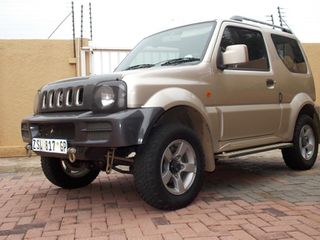

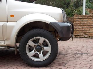

=== Examples of trimmed 2nd gen. front bumpers ===
=== Examples of trimmed 2nd model front bumpers ===
<gallery widths=320 heights=240 class=center caption="Example 1 of trimmed 2nd gen. front bumper">
<gallery widths=320 heights=240 class=center caption="Example 1 of trimmed 2nd model front bumper">
Suzuki Jimny 2nd gen front bumper, trimmed - A01.jpg|License plate attached, but it hangs and could easily rip off.
Suzuki Jimny 3 - 2nd model front bumper, trimmed - A01.jpg|License plate attached, but it hangs and could easily rip off.
Suzuki Jimny 2nd gen front bumper, trimmed - A02.jpg|Side view of the result.
Suzuki Jimny 3 - 2nd model front bumper, trimmed - A02.jpg|Side view of the result.
Suzuki Jimny 2nd gen front bumper, trimmed - A03.jpg|Close-up side view of the result.
Suzuki Jimny 3 - 2nd model front bumper, trimmed - A03.jpg|Close-up side view of the result.

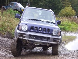

<gallery widths=320 heights=240 class=center caption="Example 2 of trimmed 2nd gen. front bumper">
<gallery widths=320 heights=240 class=center caption="Example 2 of trimmed 2nd model front bumper">
Suzuki Jimny 2nd gen front bumper, trimmed - B01.jpg|License plate kept indoors. This might not be legal everywhere.
Suzuki Jimny 3 - 2nd model front bumper, trimmed - B01.jpg|License plate kept indoors. This might not be legal everywhere.
Suzuki Jimny 2nd gen front bumper, trimmed - B02.jpg|Side view of the result.
Suzuki Jimny 3 - 2nd model front bumper, trimmed - B02.jpg|Side view of the result.

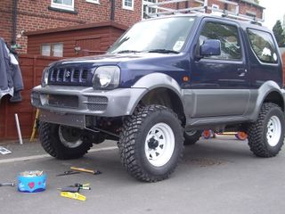

* Notice that the resulting trimmed 2nd gen. front bumper (in both examples) is actually only slightly shallower than a stock (unmodified) 1st gen. front bumper.
* Notice that the resulting trimmed 2nd model front bumper (in both examples) is actually only slightly shallower than a stock (unmodified) 1st model front bumper.
* Some people trim the 1st gen. front bumper as well. However, if you really need such high approach angles, then your vehicle is probably already so much modified that one more ugly trim does not matter for the aesthetics or fog lamp / license plate functionality.
* Some people trim the 1st model front bumper as well.
** However, if you really need such high approach angles, then your vehicle is probably already so much modified that one more ugly trim does not matter for the aesthetics or fog lamp / license plate functionality.

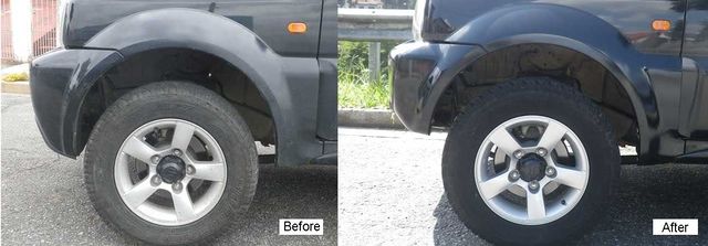

[[File:Suzuki Jimny front bumper - 1st and 2nd gen - A01.jpg|640px|thumbnail|left|1st and 2nd gen. front bumper on the same vehicle]]
[[File:Suzuki Jimny with 3rd gen front bumper - side view - A01.jpg|240px|thumbnail|right|A side view of a 3rd gen. front bumper]]
[[File:Suzuki Jimny 3 front bumper - 1st model and 2nd model - A01.jpg|640px|thumbnail|left|<div align="center">1st and 2nd model front bumper on the same vehicle</div>]]
* Here is a side-by-side comparison of 1st and 2nd gen. front bumper on the '''same''' vehicle.
[[File:Suzuki Jimny 3 with 3rd model front bumper - side view - A01.jpg|240px|thumbnail|right|A side view of a 3rd model front bumper]]
* Here is a side-by-side comparison of 1st and 2nd model front bumper on the '''same''' vehicle.
* The body color differs in the left and right parts of the image because of different lightning conditions.
* The "before" (left) part of the image is with a 2nd gen. bumper.
* The "before" (left) part of the image is with a 2nd model bumper.
* The "after" (right) part of the image is with a 1st gen. bumper.
* The "after" (right) part of the image is with a 1st model bumper.

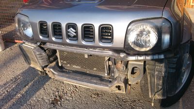

* If you attempt to mount a front bumper model which was not meant for your Jimny 3, the bumper attachment points to the brackets on the front ends of chassis rails will be misaligned.
** Therefore, you will either have to fabricate some additional brackets between the current brackets and the bumper, or to replace the current front chassis rail end brackets with suitable ones from the list above.
* Additionally, the 3rd petrol bracket model collides with the bottom end (plastic skid plate) of the 1st front bumper model, because the bracket hangs too low toward the ground in this case.
** Therefore, there are three solutions to use 1st front bumper model on a post-2012 Jimny 3 with 3rd bracket model:
**# Discard the bottom of the 1st model front bumper (its black skid plate);
**# Cut off the lower half of those brackets;
**# Replace the entire brackets with suitable brackets for 1st model front bumper;
*** Note: In the first two solutions, you will still have to fabricate a pair of additional "re-alignment" brackets to sit between the OEM brackets and the 1st front bumper model.

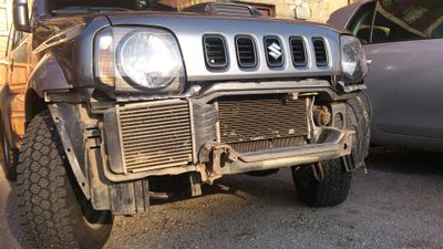

=== Example pictures of swapped bumpers ===
Pre-2013 and post-2013 Jimnys 3 have different front bonnet and grille (look at the pictures in the "Introduction" chapter):
* In pre-2013 Jimnys, the bonnet and grille are a single-piece and there are five plastic grille holes / grids in the bonnet itself
* In post-2013 Jimnys, the bonnet is shorter in the front, and there is a large fixed front grille between the front head lamps, reminiscent of a "Hummer-style" front grille.
The picture galleries below show how it looks like when a 1st and 2nd model front bumper are paired with a post-2013 Jimny, and also when a 3rd model front bumper is paired with a post-2013 Jimny.

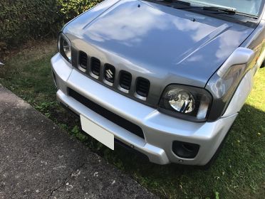

[[File:Suzuki Jimny - pre-2013 bonnet with 3rd model front bumper - A01.jpg|372px|thumb|left|Pre-2013 Jimny with 3rd model front bumper]]
<br clear=all>
It appears that it is not trivial to fit a 1st model front bumper to a Jimny 3 which originally had a 3rd model front bumper. Some parts of the chassis collide with the older bumper, and there are no mounting holes in the top of the old bumper for the center grille (between the head lamps).
However, the swap is still possible after some modifications, as shown in [https://www.drive2.ru/l/3401620/ this Russian's report].
[[File:Suzuki Jimny 3 - front bumper, 1st model instead of 3rd model - A01.jpg|400px|thumb|left|Suzuki Jimny 3, built between 2012 and 2018. It originally had a 3rd model front bumper. Now it has a 1st model front bumper.]]

It has been confirmed that replacing a 2nd gen. front bumper with a 1st gen. front bumper is not practical on DDiS (diesel) Jimnys with 63kW (intercooled) K9K engine.
It has been confirmed that replacing a 2nd model front bumper with a 1st model front bumper is not practical on DDiS (diesel) Jimnys with 63kW (intercooled) K9K 266 engine.
* The problem is that the engine intercooler sits low right up front, just above the right fog lamp.
* If you try to replace the factory-installed 2nd gen. front bumper with the 1st gen. front bumper, you will have to discard the right fog lamp (if you have fog lamps).
* If you try to replace the factory-installed 2nd model front bumper with the 1st model front bumper, you will have to discard the right fog lamp (if you have fog lamps).
* You will also have to leave open the right fog lamp hole in the 1st gen. bumper, in order to feed the intercooler with air (and even that hole might not be sufficient to feed it).
** You will also have to leave open the right fog lamp hole in the 1st model bumper, in order to feed the intercooler with air.
* You should also install some grid in the right fog lamp hole, to prevent an object going through the hole and puncturing the intercooler.
*** Even that hole might not be sufficient to feed it with enough air.
* Alternatively, you could dislocate the intercooler, but the free space in the engine bay is very scarce, and moving the intercooler is an expensive modification.
** You should also install some grid in the right fog lamp hole, to prevent an object going through the hole and puncturing the intercooler.
* Alternatively, you could dislocate the intercooler, but the free space in the engine bay is very scarce, and moving the intercooler is an expensive modification on itself.

Solution 1: Trimming the front bumper
  • Trimming the lower part of a front bumper is the quickest and (seemingly) the simplest solution to increasing vehicle's approach angle and free space around front wheels.
  • Because of all the mentioned problems with the 2nd model front bumper, many people trim the bottom half of the 2nd model front bumper, but it tends to look ugly.
  • Also, if you trim a 2nd model or 3rd model front bumper, you would probably lose your front fog lamps (if you have them) and a place to hold the front license plate.
Alternative solution to trimming a front bumper is to replace it with something else.
  • Notice that the resulting trimmed 2nd model front bumper (in both examples) is actually only slightly shallower than a stock (unmodified) 1st model front bumper.
  • Some people trim the 1st model front bumper as well.
    • However, if you really need such high approach angles, then your vehicle is probably already so much modified that one more ugly trim does not matter for the aesthetics or fog lamp / license plate functionality.
  • Here is a side-by-side comparison of 1st and 2nd model front bumper on the same vehicle.
  • The body color differs in the left and right parts of the image because of different lightning conditions.
  • The "before" (left) part of the image is with a 2nd model bumper.
  • The "after" (right) part of the image is with a 1st model bumper.
  • The side view picture of a 3rd model front bumper might not be directly comparable with these two on the left, because it was not taken from the exactly the same angle.
  • In pre-2013 Jimnys, the bonnet and grille are a single-piece and there are five plastic grille holes / grids in the bonnet itself
  • In post-2013 Jimnys, the bonnet is shorter in the front, and there is a large fixed front grille between the front head lamps, reminiscent of a "Hummer-style" front grille.

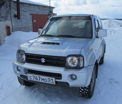

However, the swap is still possible after some modifications, as shown in this Russian's report.

Inner front wheel arches
  • Inner front wheel arches (black plastic arches) have different length for different bumper models.
    • Your current ones will either be too short with the new bumper, or you will have to shorten them (depending on what you are replacing with what).
  • If you are swapping a 2nd model front bumper with a 3rd model or 1st model front bumper (or a 3rd model front bumper with a 1st model front bumper), your old inner front wheel arches will be too long for the new bumper.
    • The simplest remedy is to trim the front bottom part of the inner wheel arches.
      • However, it would be more advisable to buy the matching front inner wheel arches together with the new front bumper.
      • This leaves your old front inner wheel arches intact for future use or for selling.
  • On the other hand, if you are (for some impractical reason) replacing your 1st model front bumper with a 2nd model or 3rd model front bumper (or a 3rd model front bumper with a 2nd model front bumper), then you will have to buy the matching front inner wheel arches, because your old ones will be too short.

Restrictions with DDiS Jimnys
  • The problem is that the engine intercooler sits low right up front, just above the right fog lamp.
  • If you try to replace the factory-installed 2nd model front bumper with the 1st model front bumper, you will have to discard the right fog lamp (if you have fog lamps).
    • You will also have to leave open the right fog lamp hole in the 1st model bumper, in order to feed the intercooler with air.
      • Even that hole might not be sufficient to feed it with enough air.
    • You should also install some grid in the right fog lamp hole, to prevent an object going through the hole and puncturing the intercooler.
  • Alternatively, you could dislocate the intercooler, but the free space in the engine bay is very scarce, and moving the intercooler is an expensive modification on itself.
