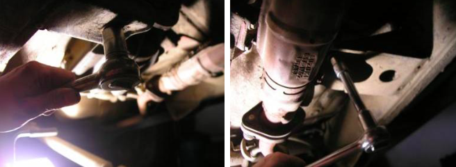

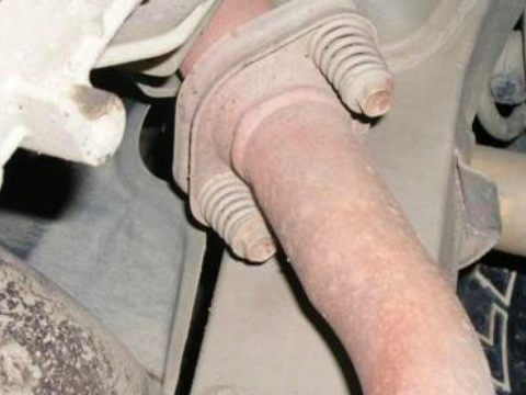

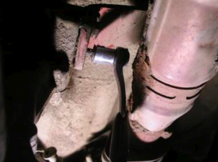

| − | + | [[File:Clutch replacement guide - figure 08 - exhaust bolts.png|thumb|left|480px|Figure 08 - exhaust bolts]] | |
| − | + | * Now remove the front section of the exhaust pipe. | |
| + | * This is held in place by pairs of springs with bolts inside. | ||
| + | * Due to the heat and stress, the front bolts were really, really difficult to move. | ||
| + | * So much so, I think there is real possibility of shearing them on some cars. | ||
| + | * There is a pair at the front and a pair at the back. | ||
<br clear=all> | <br clear=all> | ||

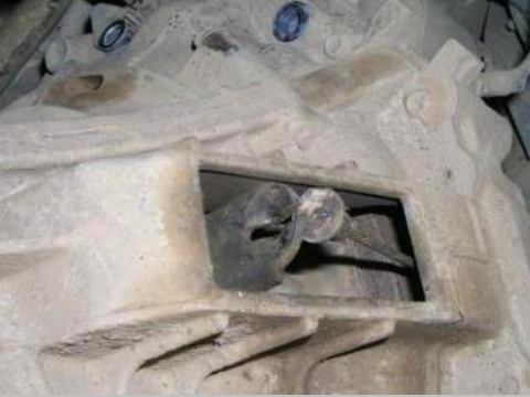

| + | === Clutch Cable === | ||

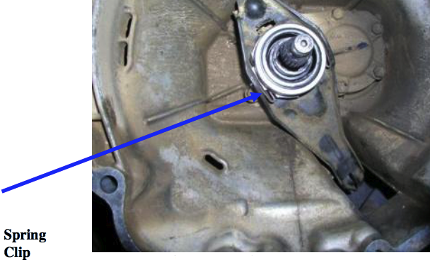

| + | [[File:Clutch replacement guide - figure 18 - clutch cable (unhooked).png|thumb|left|480px|Figure 18 - clutch cable (unhooked)]] | ||
| + | * We are nearly there now. | ||
| + | * Remove plastic clutch housing cap and prise the end of the clutch cable from clutch release fork. | ||
| + | * Then undo the two bolts holding the clutch cable to the transmission and withdraw the clutch cable assembly. | ||
| + | * Also remove the small tin-plate on the bottom front of the clutch housing held on by a pair of small 10mm bolts. | ||
| + | <br clear=all> | ||

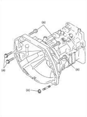

| + | The official workshop manual now says to undo the bellhousing bolts and lower the gear box away from the engine. Whoever wrote this must have been smoking something very exotic, or was planning on quitting the job soon. | ||
| + | [[File:Clutch replacement guide - figure 19 - gear box bolts.png|thumb|left|360px|Figure 19 - gear box bolts]] | ||
| + | * The first problem is to locate all the bolts on the bellhousing as they are well hidden. | ||
| + | * Take a close look at the picture and locate all the bolts. | ||
| + | The next problem is undoing them as there is no room to get a socket set in. I had to use a complex combination of extensions and flex joints from two socket sets to get to a couple of the bolts. Also note that there is very little chance of the gear box falling off once the bolts are undone so don’t spend a lot of time supporting it. | ||
| + | Separating the gear box from the engine can be a real pain (literally). The gear box is located on studs and corrosion can hold it in place. I had to hit the bellhousing edge with a large hammer (protecting the metal with a wooden block) before it would separate. | ||

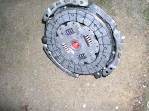

| + | [[File:Clutch replacement guide - figure 23 - wrong release bearing is on right.png|thumb|left|480px|Figure 23 - wrong release bearing is on right]] | ||
| + | * I originally purchased a cheap kit (CPK1086) from Ebay, this was before the Bigjimny shop! | ||
| + | * The quality seems OK (it is stamped as being made by AISIN – who supply Suzuki with parts). | ||
| + | * The only issue being that it was supplied with the incorrect release bearing. | ||
| + | * The company immediately shipped the correct bearing free of charge and assured me that the correct bearing should have been in the kit. | ||
| + | * Also note that the new plate has 4 springs whilst the old one has 3, again I have been assured that this is OK. | ||

- This is held in place by pairs of springs with bolts inside.
- Due to the heat and stress, the front bolts were really, really difficult to move.
- So much so, I think there is real possibility of shearing them on some cars.
- There is a pair at the front and a pair at the back.
- The first problem is to locate all the bolts on the bellhousing as they are well hidden.
- Take a close look at the picture and locate all the bolts.
- Once it is separated you have to drop the gear box down.
- The transmission tunnel is so tight that this appears to be a near impossible task.
- I had to jack the engine forward to gain as much room as possible.
- You will also find that the gear box will move backwards a little way in the tunnel.
- This means you can then open a useful gap around the clutch.
- Some people have changed the clutch using just this gap.
- Instead, I undid the clutch cover bolts and removed the clutch assembly with the gear box still in place.
- Removing the clutch then meant there was just enough room for the gear box to be pulled out.

- Within the clutch kit should be a new cover, new plate and new release bearing.
- The old release bearing is removed by prising the spring clip out of the mounting and sliding it out of the spring.
- Re-assembly is just as easy.
- Make sure that the splines are lightly greased and the inside of the release bearing where it slides on the shaft is greased (not the bearing itself – this should be lubricated by the factory).
Put grease on the moving points of the clutch release arm as well.
- I originally purchased a cheap kit (CPK1086) from Ebay, this was before the Bigjimny shop!
- The quality seems OK (it is stamped as being made by AISIN – who supply Suzuki with parts).
- The only issue being that it was supplied with the incorrect release bearing.
- The company immediately shipped the correct bearing free of charge and assured me that the correct bearing should have been in the kit.
- Also note that the new plate has 4 springs whilst the old one has 3, again I have been assured that this is OK.
- Assemble the new clutch mechanism using a clutch alignment tool.
- I got mine cheap - £1 – as it was a girlie pink colour and had remained unsold in the shop for a long time.
- With this tool you assemble the clutch off the car and then lift the whole unit into place and bolt down the clutch cover to the flywheel.
- Remove clutch alignment tool.

Refitting the gear box
With the engine still jacked forward it should be possible to jack the gear box back into place using the weight of the car to help force it into position. Before trying to mate it back with the clutch allow the engine to drop back into its proper position (not too far back) – this will make it easier to align.
It should now be possible to wiggle the gear box forward.
First of all check that nothing is in the way – I failed to notice the reversing light switch had fallen down and I severed the cable which had become trapped.
Fitting the gear box is one of those tasks where you will have repeated attempts to get it to go and then it will suddenly “click” – it will need lots of tiny jiggles to creep it onto the studs.
Refit all the bolts that hold the gear box in place (use Copper Grease on the bolts to make it easier next time!)
