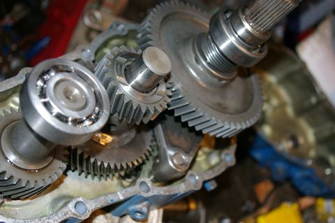

[[File:Transfer box conversion to Rock Lobster guide - figure 20.jpg|thumb|left|480px|Figure 20 - input shaft in position]]
* First of all insert the input shaft on its own.
** Assemble (and bolt together) the case WITHOUT a gasket and check how the shaft turns.
** If it is stiff then it is fine and no shims are needed.
** If it turns freely then disassemble and add a shim.
** Rebuild the case and see if the shaft becomes stiff to turn.
** Once it does then it is correctly shimmed.
* Now you can move on to the output shaft.
** Again, repeat the process with only the output shaft and WITHOUT the gasket.
** Keeping adding shims until the output shaft is stiff to turn.
* This process works because you have not fitted the gasket.
* Once it is fitted it adds the correct spacing!

* First build the input Shaft onto the middle case section.
* I found the input shaft difficult to insert.
* In the end I refitted the flange and tightened the flange nut to pull the gearset into position.
* Then fit the intermediate shaft and finally the output shaft
* Then fit the intermediate shaft and finally the output shaft.

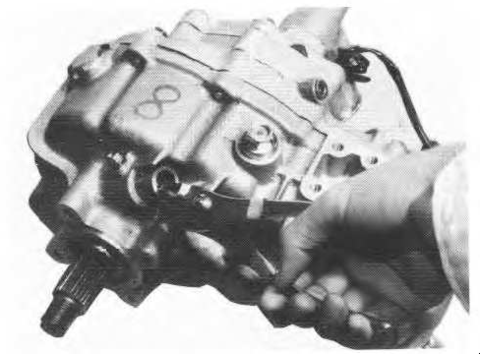

Figure 01 - removing the shifter
  • First you have to get both transfer boxes onto the workbench.
  • Drain the oil - leave it to drain for a while, you will get oil everywhere anyway!
  • Remove the mounting points.
  • Remove the gear lever, if this was not done when removing it from the vehicle.
    • This is achieved by removing the rubber gaiter and by pressing and rotating the retaining plate.

Figure 21 - all shafts in position
  • First build the input Shaft onto the middle case section.
  • I found the input shaft difficult to insert.
  • In the end I refitted the flange and tightened the flange nut to pull the gearset into position.
  • Then fit the intermediate shaft and finally the output shaft.

Figure 25
  • Now replace the flanges and drum brake assembly (if required).
  • Stand back and admire your work.
