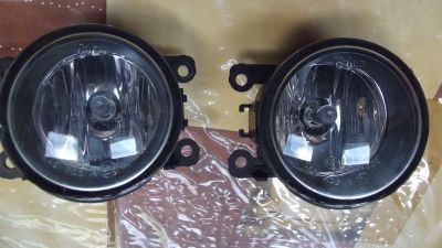

* The following fog lamp models appear to have exactly the same dimensions, shape, bulb, el. connector and mounting points to the brackets:
*# <font face="courier">35500-63J04</font> - "main" / standard edition from Suzuki (with exceptions below);
*#* It appears that the actual fog lamp product under this Suzuki catalogue number is made by Valeo, P.N. <font face="courier">89210094</font>.
*#* The actual fog lamp product under this Suzuki catalogue number is made by Valeo, P.N. <font face="courier">89210094</font>.
*#** It appears that alternate catalogue P.N. for this fog lamp model is P.N. <font face="courier">088358</font>.
*#*** Not stamped on the fog lamp itself, but stated in some catalogues as a "virtual" / formal catalogue Valeo number.
*#** The same (or very similar) lamp is used by:

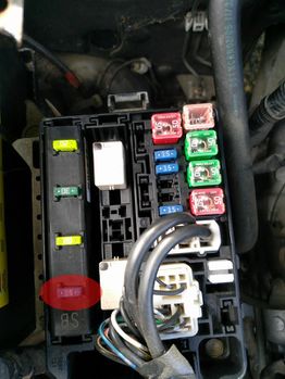

[[File:Suzuki Jimny 3 - fuse for front fog lamps - A01.jpg|400px|thumb|left|Main fuse box in a Jimny 3 type 5, with the existing 15A fuse for the front fog lamps marked with a reddish ellipse area.]]
<gallery widths=500 heights=350 class=center caption="">
[[File:Suzuki Jimny 3 - el. connector in the engine bay, front fog lamps - A01.jpg|450px|thumb|center|Unused "Cable connector 4" just behind the front left head lamp (in a LHD Jimny type 9, made in 2012)]]
Suzuki Jimny 3 - fuse for front fog lamps - A01.jpg|Main fuse box in a Jimny 3 type 5, with the existing 15A fuse for the front fog lamps marked with a reddish ellipse area.
<br clear=all>
Suzuki Jimny 3 - el. connector in the engine bay, front fog lamps - A01.jpg|Unused "Cable connector 4" just behind the front left head lamp (in a LHD Jimny type 9, made in 2012
</gallery>

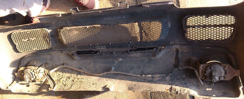

Fog lamps 35500-74F50 with brackets 35526-81A01 mounted in 1st model front bumper, rear view
Fog lamps 35500-63J0x with brackets 35526-84A00 and 35566-84A00 mounted in 2nd model front bumper, rear view

    1. First search for the unused Cable connector 4 in the engine bay, just behind the head lamps.
      • In Jimnys 3 type 1-5, there should be ??????? behind ???????.
      • In Jimnys 3 type 6-8, there should be one unused connector behind one of the head lamps (usually left).
      • In Jimnys 3 type 9-12, there should be one unused connector behind each head lamp (so two connectors in total).
      • If not found there, then search for it/them somewhere behind the front bumper (after removing the front inner wheel arch liners).
    2. Then check if the unused Cable connector 3 for the console button / switch is present inside the console in the cabin (see the chapter about the installation of the console button / switch).
  • If you find both unused Cable connector 4 and Cable connector 3 (for the fog lamps and for the in-cabin switch) in your Jimny 3, consider yourself lucky!

Notes on Cable connector 5:
  • There are two types Cable connector 5 for front fog lamps in Jimnys 3.
    1. The first connector type was used in all Jimnys 3 type 1-5 (which originally came with 1st model front bumper, from 1998 to approx 2005).
      • This connector type is compatible only with front fog lamp model 35500-74F50.
        • All other / newer fog lamp models which use H11 bulbs (including OEM fog lamps 35500-63J0X) can be connected to the first / old type of Cable connector 5 through a suitable connector adapter 36813-54G20.
          • This adapter is exactly the same as the wire harness 36813-57M00 (same connector on both ends), only the harness is slightly longer. They can be interchanged!
    2. The second / newer Cable connector 5 type was used in all Jimnys 3 type 6-12 (which originally came with 2nd and 3rd model front bumper, from approx 2005 to 2018).
      • This newer Cable connector 5 is actually a direct male connector for bulbs made according to H11 bulb standard.
        • It is directly compatible with all fog lamp models 35500-63J0X, as these fog lamps use H11 bulbs.
        • It is incompatible with front fog lamp model 35500-74F50 (which was not meant for 2nd and 3rd model bumpers anyway, since no brackets for that combination are available).
          • However, a required el. connection could probably be made by cutting the Cable connector 5 off and soldering the Wiring 4 to the fog lamps directly.
Cable connector 5 as used by the fog lamp model 35500-74F50. This is the connector from the side of the fog lamp. Note that it happens to physically match Cable connector 4 from the picture above which taken from a much newer Jimny built in 2012, although they are not meant to be directly connected.

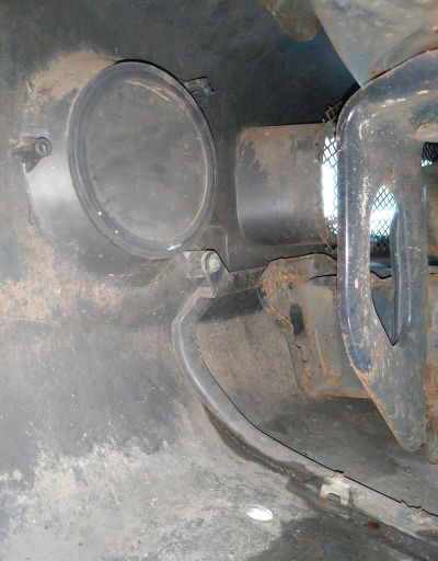

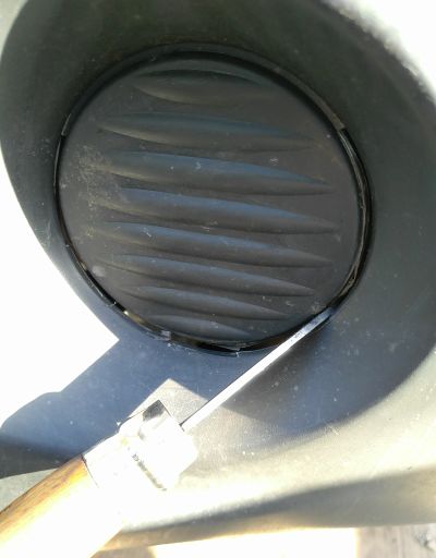

Installation in the front bumper
In the case of 1st and 2nd model front bumper, you first have to cut out the plastic blanks in order to open the holes through which the fog lamps will illuminate the space in front of the vehicle. As this is an irreversible operation, it is advised to do this only after obtaining all the parts and test-connecting all the wiring to prove that it all works as planned.
Cutting out the plastic blank cover for the fog lamps in 1st model front bumper
View of the space behind the 1st model front bumper when mounted to the vehicle, which a front fog lamp will occupy. The circle needs to be cut out, and the fog lamp bracket needs to bolt on to three plastic holes around the circle.
