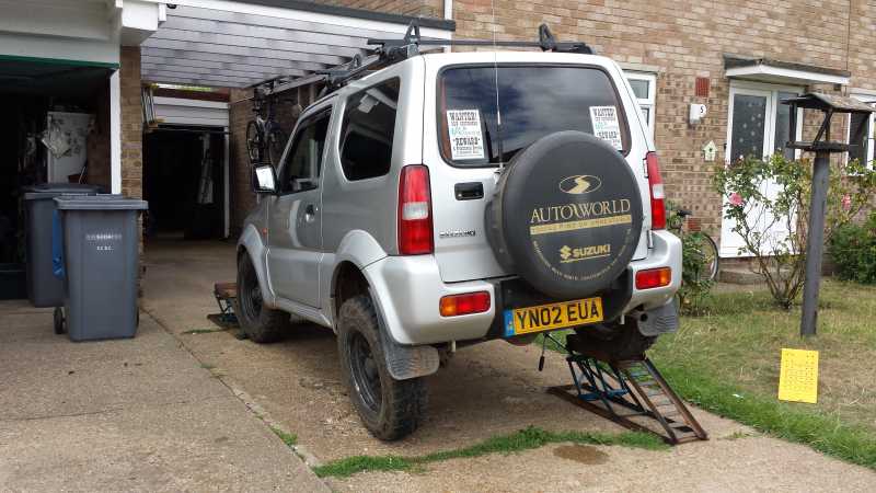

tested my articulation yesterday by driving onto car ramps at opposite corners and was shocked at how little the front has before you start spinning the "grounded" tyre!
