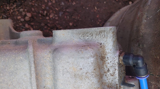

Thanks guys.
I was trying to keep the reviews towards on road experience as that's where this vehicle will live most of the time as a commuter car doing 90 mile daily round trips once or twice a week.
It already has a stock Samurai box running 235/75-15 under 2" suspension & 2" body lift
But of course I want to go taller tyres (don't we all)
Diffs. I did think about them but don't want to cut the axle. Did think about a complete axle swap.
I was offered the RW built rock lobster book for £300 so took it as it seemed like a great deal but now thinking it may be too low geared.
