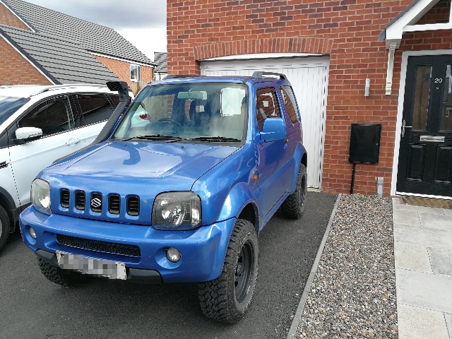

I intend to buy some steel wheels to replace the alloys (just prefer the look) and have found some that are 6.5 x 15 ET -10. By my calculations, that adds 2.5mm inwards and 22.5mm outwards compared to the standard 5.5” wheels. The 2.5mm inwards is not going to make any difference, but I wondered about the 22.5mm outwards. If I drop a plumb line down from the arch, I’m fairly sure it should stay within the wheel arch (might depend on tyres), and hence road legal. The second question is regarding the potential for death wobble. Unlike wheel spacers, using a wider wheel with a little negative offset keeps the face of the wheel against the hub, and so most of the weight is still in the same vertical plane – there is just another 22.5mm of rim protruding. Whereas spacers throw the whole weight of the wheel further out from the hubs, increasing unsprung weight, and giving potential suspension/steering wear problems.
So, does anyone have any thoughts on:
1. Will 6.5 x 15 ET -10 sit nicely within the wheel arch line? (30mm spacers, from what I’ve seen, seem protrude past the wheel arch)
2. Is the extra weight of a steel rim or the extra 22.5mm width likely to increase the chances of death wobble?

1. Should be OK and within using a 215 wide tire. Wider like 235 would come a bit out as it is just within on the original wheels.
2.should be ok. If they make a wobble you should first check the bearings and usual wobbly stuff...
