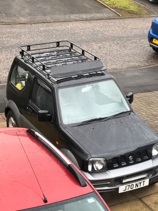

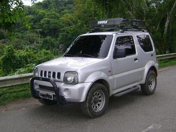

- Roof mounted metal basket;
- OEM and the aftermarket offer several suitable accessory products;

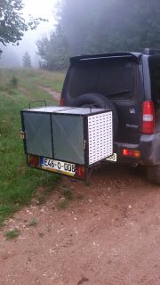

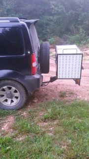

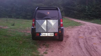

- Tow bar mounted box;
- The aftermarket offers several suitable accessory products;
- A DIY solution is also easily achievable;

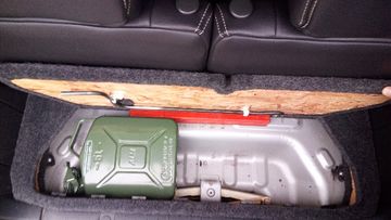

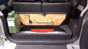

- Suitably sized hard-case box in the trunk, with sectioned chambers in the box (similarly like a toolbox);

- Solution #4 might not be legal, or might require the use of additional license plate and brake + turn lights.

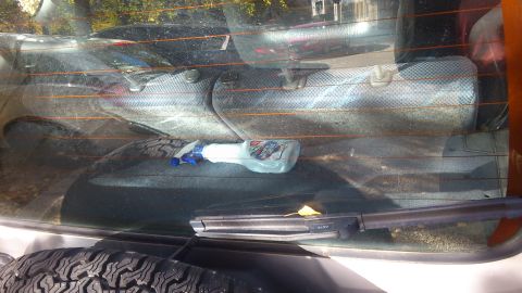

- Put a blanket over the cargo in the trunk (could be counter-intuitive!);

- Solution #1 might not totally obscure the vision from the outside towards the inside, depending on lightning conditions on the location.
- Solution #3 provides the best concealment, but can be quite awkward (roof box is very high up, also the need to operate it separately from the car's locks, etc.).
- Solution #5 might even entice additional curiosity from the viewer.

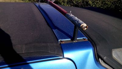

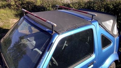

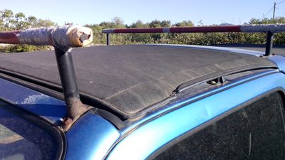

- However, all "cabrio" Jimnys 3, as well as some (mostly low-end) "closed cabin" Jimnys 3, don't have those longitudinal rails.
- There are no known aftermarket-made transverse roof rails for such Jimnys.
- Therefore, if you have a "cabrio" Jimny 3, or a closed-cabin Jimny 3 without factory longitudinal roof rails, you most probably can not mount roof rails nor a roof box (unless you install some DIY rails).

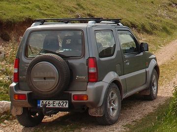

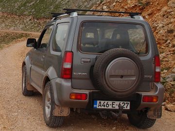

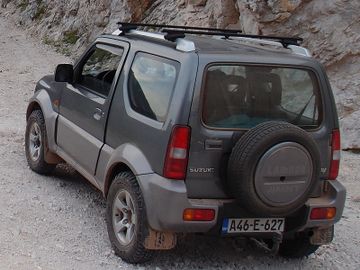

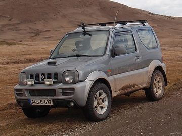

- Jimny 3 with transverse mounted steel roof rails (Thule SquareBar 761) and Thule 775 connecting 'feet'
- Cabrio Jimny 3 with DIY (improvised) transverse mounted steel roof rails - spotted in a countryside
If you have a closed cabin ("tin-top") Jimny 3 without longitudinal rails, you might be able to transplant the rails from another dead Jimny from a vehicle junkyard (this has not been tried yet). This is certainly not possible on cabrio Jimnys 3, even with the hard top.

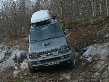

Roof boxes off road
- You can regularly go off road with the roof box on, just bear in mind that your center of gravity is higher with the roof box on (especially with cargo in it).
- It is important that the box is of high quality so that it can withstand vibration abuse when driving on gravel and off road.
- When driving through very overgrown tracks in forests, the roof box might collide with low branches. This requires extra caution not to hit thick / strong branches, which have to be cut off before passing.

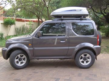

- Their smallest current roof box size is called "100" / "S" (depending on the market);
- Size 100 / S main data: approximate volume 330-370 l (depending on roof box design), approximate dimensions (L x W x H) 140 x 90 x 40 [cm];
- Examples of Thule roof boxes in size 100 / S: Polar 100, Ocean 100, Pacific 100, Touring 100, Touring S, Motion S, etc.;

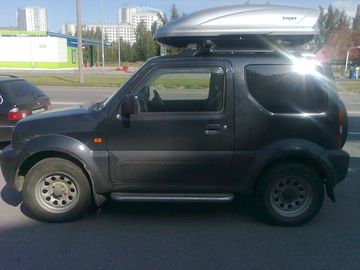

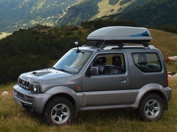

- Suzuki Jimny 3 with roof box Thule Ocean 100
- Suzuki Jimny 3 with roof box Thule Pacific 100

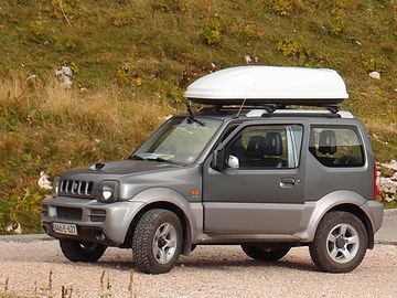

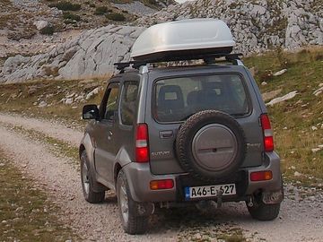

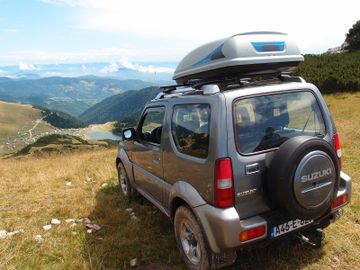

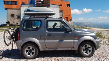

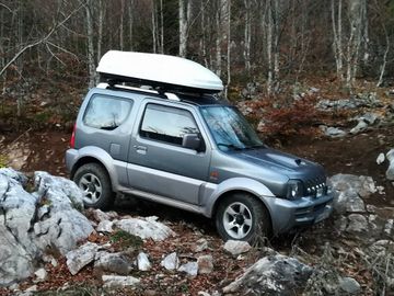

Usability experiences:
- Size 80 is a bit too small, but fits quite nicely nonetheless.
- Sizes 100 / S and 200 / M fit great and look great too.
- Size 780 / L also fits, but looks just a bit bulky (pictures needed!).
- Anything larger than that looks like a boat on the roof.
- Suzuki Jimny 3 with a huge roof box made by Mont Blanc, unknown model
Roof baskets
- Roof baskets provide the most versatility and the best utility value.
- Apart for being able to store various items "inside" them (just like in a roof box), you can also attach various items to their sides, like shovels, tools, flags, rain collectors, radars ...
- However, all items have to be secured / strapped well and insulated from adverse weather.
- Roof baskets are best suited for remote overland expeditions where population is scarce and you never move far away from the car - another person (or a monkey) can easily mess with the cargo on the roof!
- The prerequisite for mounting some roof baskets (depending on the model) is having a pair of transversely mounted roof racks (rails).
- See the corresponding chapter for details about roof rails.
- Some roof baskets bolt directly onto the roof, and therefore usually require prior removal of factory fitted longitudinal roof rails.
- Suzuki Jimny 3 with roof basket Thule Xperience 828
Tow bar mounted boxes
If you are desperate for having additional cargo space in a Jimny (and who isn't!?), you might also consider using a tow bar mounted cargo box.
An example of a tow bar mounted cargo box is "Thule BackUp 900". That one can even be combined with some of their platform mounted tow bar bicycle carriers.
Specially designed tow bar mounted cargo boxes with ventilation openings are used by some hunters to transport hunting dogs.
An example of a custom-made tow bar mounted dog box on a Jimny 3:
That dog box on the pictures with a black Jimny 3 is additionally secured to the car by a pair of straps linking it with the rim of the spare tyre. That reduces the vibrations inside the box during driving. Alternatively, the securing straps could be designed to attach to each side of the rear doors, in a similar manner like this Italian bicycle carrier uses them.
Read the wiki article "Tow bar" for details on installing a tow bar (if you don't have it) and using the existing one.
Beware that a tow bar mounted cargo box will block the rear door, so you can not open the rear door while the box is mounted. You can not open the door even if the box is a tiltable design, because no matter how much you tilt it away, it won't provide more than a couple of inches of space to open the door. The spare tyre is the main cause of the lack of maneuverability.

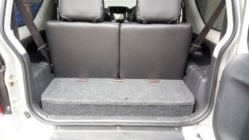

Jimny 3 - Example 1
- This DIY solution has been made by forum user Hun.
- DIY hard-case storage box in the bottom of Jimny 3's trunk
- This is a wooden box with some upholstery glued on it and with metal hinges on the top cover.
- The height of the box is such that it is level with the rear seats when they are folded down, forming a neat uniform surface in the rear in that situation.
- The box is sturdy so it can hold significant weight on top of it, "doubling" as a "double floor" as well.
- Additionally, the box has no bottom.
- This means that you can remove the factory fake trunk bottom, to join the space in the DIY box with the space in the recessed floor in the boot (where the vehicle jack is stored) - see picture 3 in the above image gallery.
- This way, the usability of the space in the DIY box is further enhanced.
