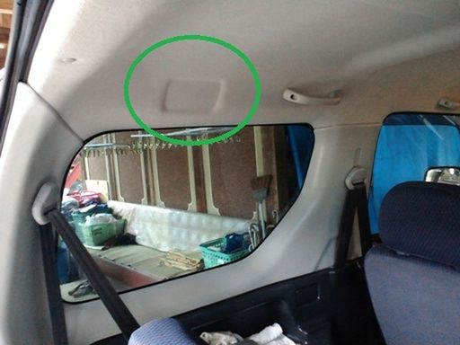

- Most Jimnys have a factory-made hole in the body above the rear left window, which was meant for a rear cabin lamp.
- However, only some high-spec "Japanese domestic market" Jimnys have that lamp installed from the factory.
- On most other Jimnys, that hole is covered by the roof upholstery, with the position of the hole clearly stamped in it.
- The solution is to retrofit the required parts in this position and to wire everything properly.
- The goal is to have the rear cabin lamp which behaves identical to the front cabin lamp.
- Note: If your Jimny does not have the stamped recess in the roof upholstery as shown in the picture, it may not also have the prepared mounts in the roof behind it.
- You will need to investigate that before you cut out the upholstery!

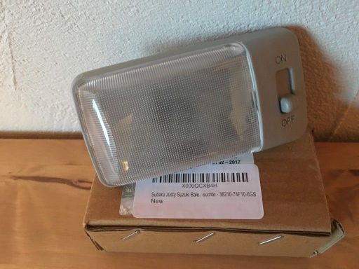

- The OEM part number of the lamp is 36210-74F02-6GS.
- OEM lamp P.N. 36210-74F10-6GS should also be compatible (it looks the same as the above one).

- The lamps P.N. 36210-74F02-6GS and 36210-74F10-6GS have only two switch positions written on their bodies ("ON" and "OFF"), and no "DOOR" position.
- However, it has been confirmed that the intermediate "DOOR" position actually exists in the lamps' switch, but is simply not written on lamps' bodies.
- Therefore, these lamp models can work in automatic mode to shine only when a door is open.

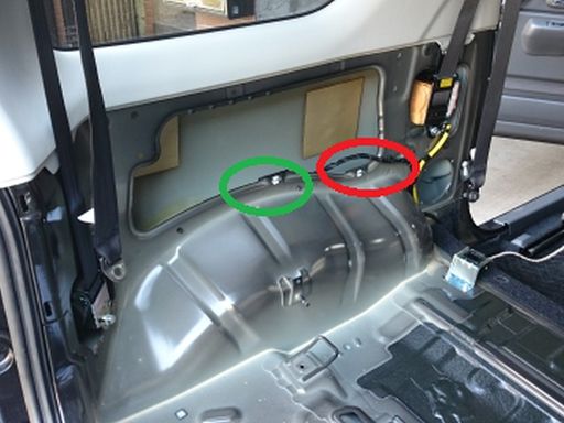

If the vehicle has prepared wiring
- Look for an unused 3-wire connector which is located in the green-rounded or the red-rounded area in the picture.
- If you find it, just connect the rear cabin lamp to it (preferably using the OEM wiring kit) and bring more light into your life.
- There might also be a 4-wire connector in the same area (usually with two green wires and two grey wires).
- That one is meant for the rear speakers - DO NOT use it for the rear cabin lamp!

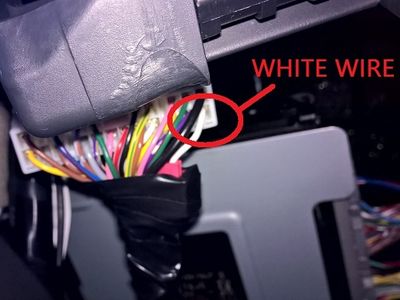

- Connect the 3rd wire from the rear cabin lamp to the power wire for the front cabin lamp.
- This one is easier said than done, as this wire is located far away - in one of the front foot wells (behind / below the dash board).
- You will have to install the 3rd wire throughout the cabin, all the way from the rear cabin lamp to near the bottom anchor of the front left seat belt, and then further on somewhere under the trim below a side door, and then finally splice it into the wiring loom in the front foot well.
- According to one forum report, here is the wire to which you need to connect the 3rd wire from the rear cabin lamp.
- It is a white wire (red-circled in the picture) in the connector which is located behind the left part of the dash board.
- That should be above the gas / brake pedals in LHD Jimnys, and behind the passenger storage compartment in RHD Jimnys.
- Note that the wiring for the front cabin lamp differs in different Jimnys 3 (probably depending on year on construction), so that this specific illustration is valid only for certain Jimnys (probably built from 1998 to 2005).

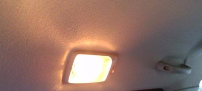

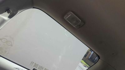

- Examples of installed and working OEM rear cabin lamp
- This is the dream which you are aiming to make a reality.
- When lamp's switch is set to OFF, it is always OFF.
- When lamp's switch is set to ON, it is always ON.
- When lamp's switch is set to DOOR (unmarked intermediate switch position), it will be shining whenever any of the doors is open.
