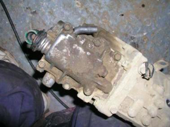

Gear box breather on a Jimny 3, factory fitment
  • The picture shows the rubber pipe that is the normal breather (minus a plastic cap which had already fallen off!).
  • The later gear box models have a bit more extended breather already.
  • Beware that an extended breather is another good candidate for slipping between the gear box and engine while you are trying to refit the gear box back into its position.
  • Simply slide some pipe onto the tub and extend the breather to a higher point on the car.
